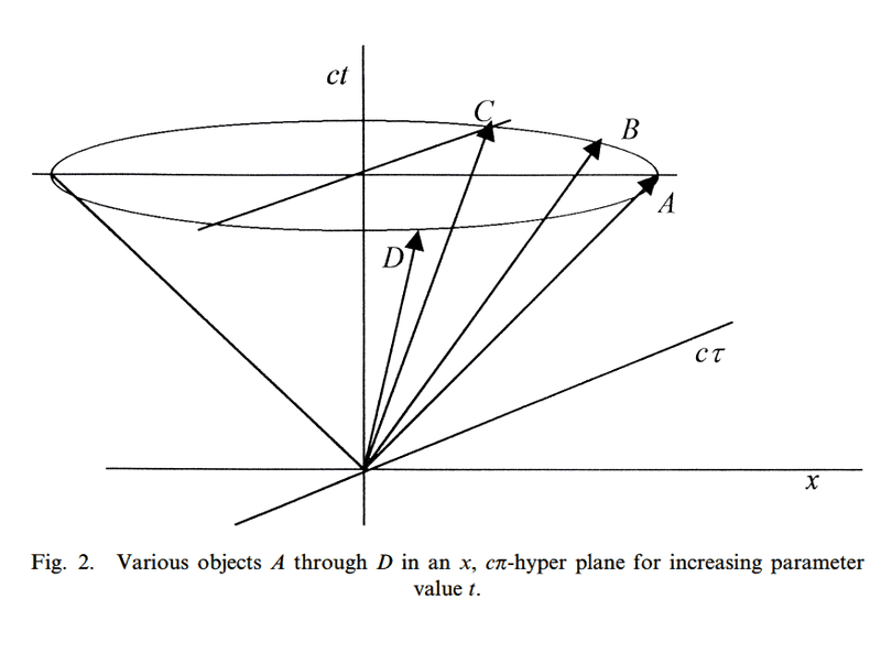

Fig 2. is Proper-Time diagram which also shows the parameter. By convention one object is assumed to be at rest, with its clock therefore showing absolute time. In this case it is particle C.
While some might claim there is no absolute time, there is the concept in Proper Time Physics.
Montanus writes: 'We therefore will restrict ourselves to an absolute Euclidean spacetime (AEST ). It will be clear that the adverb ‘‘absolute’’ should not be seen in the historical meaning of a spacetime where all the clocks run equally fast. Instead, with ‘‘absolute’’ is meant that there is a preferred frame of reference. A clock at rest with respect to this absolute rest frame will run fastest. Its time will be used as a time parameter.'
In this diagram it can be seen that particle A which is a photon moves through parameter time, even though it doesn't move through proper time. Thus using a diagram like Fig 1, one could show a light going out and returning.

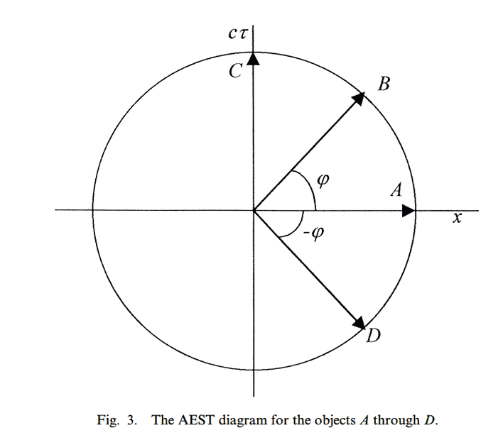

Fig 3. is the top down version if you like of Fig 2. And doesn't show the movement through absolute time. And thus such a figure wouldn't be suitable for showing light rebounding as it would all be along the same x axis. It is also worth noting that where particle D appears to have a negative proper time, according to the AEST theory a backwards running proper time of a particle is interpreted as the reversal of intrinsic properties such as charge and spin.

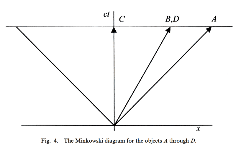

Fig 4. Is a front view of Fig 2, and does show movement through parameter time, and so would be suitable for showing a light beam going out and being reflected back. Montanus comments:
"The projection of the full diagram in Fig. 2 to the diagram in Fig. 4 illuminates why there is a light cone in the Minkowski diagram and a gap outside the light cone. It also illuminates that the trajectories of the objects moving in the AEST at an angle φ and −φ are mapped on the same trajectory in the Minkowski diagram. The present approach makes clear that the Minkowski diagram actually is a space diagram extended with a parameter axis. If one regards (erroneously) the time parameter as the simultaneous fourth coordinate for all the objects, the diagram in Fig. 4 then will be mistaken as a space-time diagram."

In Fig 2 they would imply being in exactly the same parameter time at the point of intersection, and there would be 0 spacetime distance.
If Fig 3 the line length will tell you whether they are at the same point in parameter time, and they would be 0 spatial distance I think, though there could be a distance in proper time.
In Fig 4, the Minkowski diagram, they would be at exactly the same parameter time, and there would be be 0 spatial distance, but you couldn't tell by looking whether there was any distance in proper time.

4) Light rays would only appear to retrace themselves in Fig 3 because their movement in parameter time is not shown. That would not be the case for Fig 2 or Fig 4.
Once you include coordinate time as an axis, the diagram is no longer Euclidean.

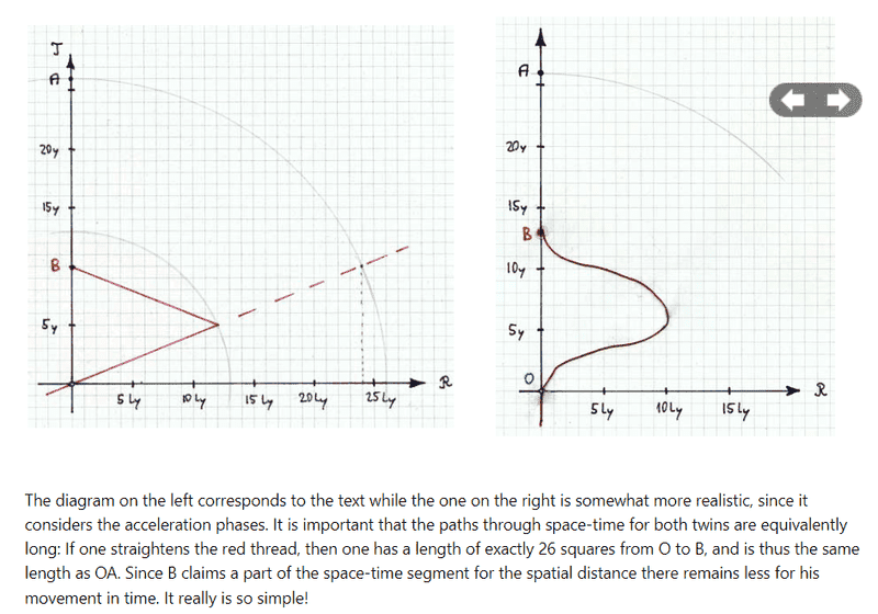

Dale said:
Two different points in space propertime can happen at the same time and place.
As @Ibix already showed, an example for this can be seen in the Epstein diagram of the twin paradox. When the twins meet again, ##A## has aged by 26 years and ##B## only by 10 year. Therefore, they are shown at different points on the ##\tau## axis.
Source (see points A and B):
https://www.relativity.li/en/epstein2/read/c0_en/c7_en

I thought Montanus was pointing out that in the Minkowski Diagram (Fig 4 attachment #55) the time is actually the parameter time, and in TR that is proper time I thought. And I thought the photons did move in that time in TR. If that is so then that is a clear physical difference between the two models, and why I guess Montanus was pointing out that people in TR had mistaken it for a spacetime diagram.
