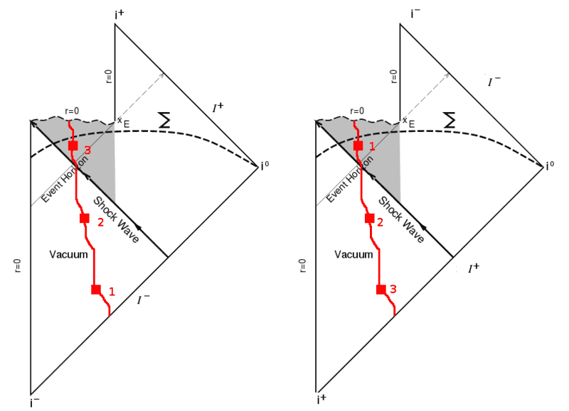

  • #105
Borrowing the Penrose diagram from figure 10 of the paper Peter linked earlier, switching a few + and - signs in the right hand copy (and I should probably have flipped the arrows on the shock wave and the event horizon but that was too fiddly), and adding a worldline with a few ticks of its proper time:
Is this argument essentially about whether those two diagrams represent distinct physical models, and/or exactly what changes are needed to make them become distinct or not distinct?

  • #107
It might be, but after realizing what I described in my previous post just now (that @stevendaryl and I have been using the phrase "time reversal" to mean different things), I'm not sure.
In addition to the issue I mentioned in that post just now (that I don't know of a good alternate term for either operation I described, reversing the time coordinate or reversing the proper time along worldlines), there is also the issue that, in the literature, it is not clear whether, for example, the labeling of the infinities, ##i^+##, ##i^-##, ##I^+##, ##I^-##, is supposed to be relative to the labeling of the time coordinate or the labeling of proper time along worldlines. As you have drawn the diagrams, you are reversing the proper time along the red worldline (since the events labeled 1, 2, and 3 come in reverse order), which is how I would do it, and you have relabeled the infinities relative to that. That makes your second diagram a distinct physical situation, since the observer whose worldline is the red worldline has the singularity in his past instead of in his future. But as @stevendaryl has described his understanding of "time reversal", the ordering of events along the red worldline would not change (so your second diagram would not be describing a "time reversal" as he has been using the term); all that would change is the sign of the time coordinate, so the events 1, 2, 3 along the red worldline would occur at a decreasing series of time coordinates instead of an increasing series of them. (I'm not sure whether @stevendaryl would relabel the infinities as you have done as part of such a transformation.)
Another issue in this discussion, I think, has been whether what I have just described (the order in which the observer experiences events along his worldline) requires thermodynamics. The diagrams you have drawn don't, at least IMO; proper time along a worldline is a geometric parameter and does not require any thermodynamics in the model. (In the idealized situations we have been discussing, including your diagrams, there is no meaningful thermodynamics since the microstate of the entire universe is known everywhere. But of course that is a physically unrealistic idealization. Part of the issue in this discussion might be what the impact of that physical unrealism actually is or ought to be.)
