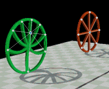

I think you need to have a look at http://www.spacetimetravel.org/filme/radv_t_0.93/radv_t_0.93-xe-320x240.mpg , there is no wobble. You can see more of the same.

  • #56
First of all, when discussing relativity we normally discount purely visual effects to get objective measurements. The links you provided have animations that include the visual effect of Terrell rotatation that obscure the physics as far a relativity is concerned unless of course we were specifically investigating Terrell rotation.

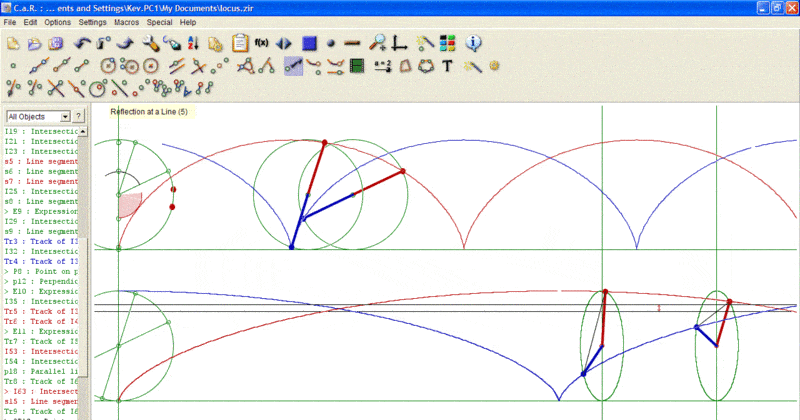

Having said that, I have taken the liberty of modifying an image from one of the pages you linked to, to illustrate the point I was making in the post you responded to. The white blobs on the rims of the attached image are equal masses placed at the end of each spoke. (Assume the spokes, hub and perimeter have insignificant mass compared to the white test masses). The red wheel is not rotating and joining opposite pairs of masses shows the centre of mass is at the physical axle of the wheel. Joining opposite pairs of test masses on the green wheel, which is moving at relativistic speed to the observer, shows that the centre of mass (the light blue dot) is now much higher than the physical axle of the wheel. I think you will agree that this vertical shift of the centre of mass is not significantly affected by the Terrell rotation that causes an optical horizontal shift of parts of the object.
kev said:
I am aware that that there is no length contraction perpendicular to the linear motion of the rolling sphere. I can guarantee that if the centre of mass is in the centre of the ball in its rest frame then it is not in the geometrical centre of the ball when it is rolling with respect to the observer. The centre of mass is further away from the point of rolling contact than the geometrical midpoint between the top of the rolling ball and the point of contact.
If you look at the bold part of my statement above my guarantee was that the centre of mass is not in the geometrical centre of the ball or wheel. I did not guarantee that the centre of mass wobbles. However, I will try and show later that is some wobble of the centre of mass, using geometrical software. I suspect this wobble is corrected by a counter rotating torque, generated by torque reactions that are result of force not always being parallel to the acceleration, in a transformed reference frame.

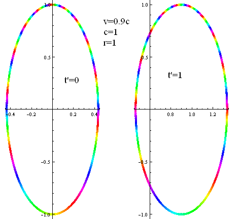

OK, I am not working today so I decided to start this. Here is an equation for the worldline of a particle on a rotating hoop in the reference frame where the axis of rotation is stationary.
s=(t,\cos (\phi +t \omega ),\sin (\phi +t \omega ),0)
in units where c=1 and r=1
Which can be differentiated to obtain the four-velocity
u=\left(\frac{1}{\sqrt{1-\omega ^2}},-\frac{\omega \sin (\phi +t<br /> \omega )}{\sqrt{1-\omega ^2}},\frac{\omega \cos (\phi +t \omega<br /> )}{\sqrt{1-\omega ^2}},0\right)
Which can be differentiated to obtain the four-acceleration
a=\left(0,-\frac{\omega ^2 \cos (\phi +t \omega )}{1-\omega<br /> ^2},-\frac{\omega ^2 \sin (\phi +t \omega )}{1-\omega ^2},0\right)
A quick check shows u.u=1 and u.a=0
I then transformed the hoop into the frame where it rolls without friction
s&#039;=L.s=\left(\frac{t+\omega \cos (\phi +t \omega )}{\sqrt{1-\omega<br /> ^2}},\frac{t \omega +\cos (\phi +t \omega )}{\sqrt{1-\omega<br /> ^2}},\sin (\phi +t \omega ),0\right)
and then differentiated to obtain u' and a'. I verified that u'=L.u and a'=L.a and that u'.u'=1 and u'.a'=0. So, kinematically everything works out just fine. I didn't actually work out the four-forces nor the tension on a differential element.
So then, to answer the question about the shape of the hoop in the primed frame I need to look at all of the points for a single value of t'.
t&#039;=\frac{t+\omega \cos (\phi +t \omega )}{\sqrt{1-\omega<br /> ^2}}
I could not solve this equation for t as described above, but I could solve it for phi to obtain
\phi =-t \omega \pm \cos ^{-1}\left(\frac{t&#039; \sqrt{-(\omega -1)<br /> (\omega +1)}-t}{\omega }\right)
Substituting this back into the expression for s' gives an expression for the shape of the hoop at a given t' in the frame where it is rolling
\left(t&#039;,\frac{t&#039;-t \sqrt{1-\omega ^2}}{\omega<br /> },\pm \sqrt{1-\frac{\left(t-t&#039; \sqrt{1-\omega<br /> ^2}\right)^2}{\omega ^2}},0\right)
I plotted this for a couple of different values of t' and it appears to be a "grape" that does not wobble.

  • #59
This is not correct. The animations provided use the exact equations (very similar to the ones just derived by DaleSpam). They use rays of light with simultaneous arrival time in order to answer the question "how does the perimeter of the sphere (or spoke wheel, arbitrary object, etc.) look in the observer 's frame at the same time t'?" .
So, contrary to what you think, in this particular application the Terrell effect is not just an illusion, it is the mechanism of determining the dimensions of a moving object by marking its extremities simultaneously. It so happens that the raytracing programs are using rays of light for this purpose.

1effect said:
This is not correct. The animations provided (please note that they are done by professional phycists) use the exact equations (very similar to the ones just derived by DaleSpam). They use rays of light that arrive simultaneously in order to answer the question "how does the perimeter of the sphere (spoke wheel, arbitrary object, etc.) look in the observer frame at the same time t'?" .
So, contrary to what you think, the Terrell effect is not just an illusion, it is the mechanism of determining the dimensions of a moving object by marking its extremities simultaneously. It so happens that the raytracing programs are using rays of light for this purpose.
I'm not sure what you mean by "determining the dimensions of a moving object"--the Terrell effect will distort the length of objects from their "correct" length in the observer's coordinate system, making the visual length longer than the Lorentz-contracted length the object actually has in the observer's coordinate system (see this thread). And the animations you show are about visual appearance, not about the spatial coordinates occupied by different points on the object at a single coordinate time.

The raytracing program simply gives a visual confirmation for the above.
  • #77
1effect said:
The argument is not based on raytracing, it is based on the fact that in the frame comoving with the sphere center there is no wobble. In this particular frame we know that the center of mass coincides with the center of rotation and the sphere (or wheel) doesn't wobble.
So, in the observer frame, the sphere (or wheel) cannot wobble either. You can't have physically different results in the two frames.
Your argument is what bwr6 called a principled argument. We know relativity predicts that the rolling ball does not wobble in the comoving frame, but that tells us little about the physics that is going on and you are not necessarily correct to jump to the conclusion that the centre of mass stays in one place as the ball rolls with constant velocity.
It is possible that centripetal forces of the masses on the rim cause accelerations that are not parallel to the the force vectors and do not act through the instaneous centre of mass. In fact I believe the centre of mass has to move to compensate for the anisotropic centripetal forces, to prevent the "wobble".
I have attached a screendump from geometrical software that I used to simulate the motion of the particles under transformation. A line joining the red and blue particle shows the instantaneous centre of gravity and the two parallel black lines in the lower part of the diagram show the heights of the centre of mass at different points during the rotation of the ball. I have taken reasonable care to ensure an accurate simulation but I can not deny that the time dependent vertical harmonic motion of the centre of mass of the horizontally moving ball, may be an artifact of the resolution and accuracy of the geometrical software.

The results of your simulation depend on the equations you used. I would be very interested in seeing them.
  • #79
Since the point-trails follow elliptical paths, they seem to be "rotating" about two centers of mass displaced in time. By "rotating", I mean a string of length \frac{2r}{\gamma} tied off to two foci (centers of mass) displaced in time by 2r\sqrt{1-\frac{1}{\gamma^2 }} seconds should transcribe an ellipse (when held taut while rotating about the midpoint of the two foci) half the size of your point trails (analogous to the 2r radius hoops in the non-relativistic case).
For the time displacement, I rotated what I calculated for the focal point separation of the Lorentz-contracted ellipsoid 90 deg.

Well, I couldn't figure out how to determine the center of mass, but I did figure out how to color my Mathematica plots according to phi. So, if you look at the attached plot this is
plotted for w=0.9c with t'=0 on the left and t'=1 on the right. In the coloring, each repetition of a given color represents a 30º chunk of hoop in the frame where the axis of rotation is stationary. So, for example, look at the left picture where the amount of hoop between the two blue spots next to the positive y-axis is equal in mass to the amount of hoop between the two blue spots closest to the negative y axis. This is despite the fact that the distance is much greater on the bottom in this frame. In other words, the hoop is more "dense" on the top than the bottom.
This picture doesn't give you an analytical equation for the center of mass, but visually you can see that the center of mass will be somewhere on the positive y-axis for both hoops. I cannot guarantee or prove it, but it looks to me like the center of mass doesn't change it's y-coordinate, although the y-coordinate of the center of mass is not 0.

Imagine we have a rotating wheel with the axis of rotation stationary if frame S with a pen attached to the rim of the wheel and a moving paper chart behind the wheel on which the pen draws a graph. The path of the the pen in this frame is a circle and the graph is a cycloid. The equation for the circle and cycloid (in parametric form) are well known. In frame S' the observer is co-moving with the paper chart.The paper chart was length contracted in frame S because it was moving in that frame, so in frame S' the paper (and graph) is "stretched" in the direction parallel to the relative motions of the frames, so the equation for the transformed cycloid is the conventional parametric equation with x*gamma substituted for x. The transformed circle path is simply an ellipse with semi-minor axis (b) and semi-major axis (a) with the relationship b=a/gamma. The exact location of the pen at any time t' in the transformed frame is the intersection of the elliptical path and stretched cyloid graph. Finding the intersection mathematically is very difficult (although it might be possible using the Lambert W function which I think is implemented in Mathematica). Fortunately the free geometrical software I use, called "CaR" for Compass and Ruler can compute the intersection of two locii but I am pretty sure it uses numerical techniques to achieve this. Most commercial geometrical software is unable to find the intersection of two locii.
  • #87
So, do you have any equations to drive your drawings or not ?
  • #88
Isn't your "stretched cycloid" an elliptical path twice the size of the transformed circle (albeit rotated 90deg, and translated such that its' center lies on the x-axis)?
Unless I'm not reading your picture correctly, the "chunks of hoop" appear to be rotating in the wrong direction.

Hmm, I should have numbered my equations to make talking about them easier. There are 7 equations in total, so eq1 is the first equation and eq7 is the last.
kev said:
It is not clear to me how Dalespam was able to plot the last equation that contains both t' and t when he has stated it is not possible to solve for t in terms of t'.
It was not possible to solve eq5 for t. But I could determine the range of t directly from eq7, I just left it out for brevity, but here it is explicitly:
The y-coordinate in eq7 is imaginary unless
1-\frac{\left(t-t&#039; \sqrt{1-\omega ^2}\right)^2}{\omega ^2}\geq 0 eq8
which gives:
t&#039; \sqrt{1-\omega ^2}-\omega \leq t\leq t&#039; \sqrt{1-\omega ^2}<br /> +\omega eq9

Actually, that is correct. If you take a set of events which are simultaneous in the axis frame then they are not simultaneous in the rolling frame, and their transformed locations are "smeared" out such that it is wider than it is high.
kev said:
This is due to the "catch 22" situation of not being able to calculate phi without knowing how the proper time of each element transforms and it is not possible to calculate how the the proper time of each element transforms without knowing how phi transforms. On the face of it, the equation is not taking the simultanity issues into account between the transformed frames.
Eq5 takes simultaneity into account in the rolling frame, and therefore eq7 describes events which are simultaneous in the rolling frame.
Regards,
Bill
Hi Bill,
I tend to agree with your observation. There appears to be a small mistake in DaleSpam's original equation that has the ball rotating counter clockwise while translating from left to right in the positive x direction which does not agree with the contact point being at the bottom. This is a non fatal error that is easily corrected by reversing the sign of the y coordinates.
