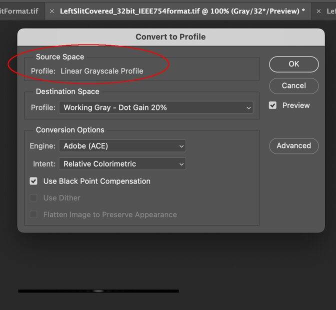

I shot in RAW NEF format, white balance while shooting was set to sunlight, picture control was on standard instead of neutral (i'll retest), active d-lighting was off, auto ISO was off, everything was manual, all in camera noise reduction was turned off, RAWs were converted to 16 bit TIFs w/ all sharpening/noise reduction off and without any other modifications.
PS… according to this, picture control doesn’t affect the RAW files, only the JPGs or raw file conversion if you use the Nikon raw conversion software, which I didn’t do… I used adobe lightroom: https://www.dpreview.com/forums/thread/3600835

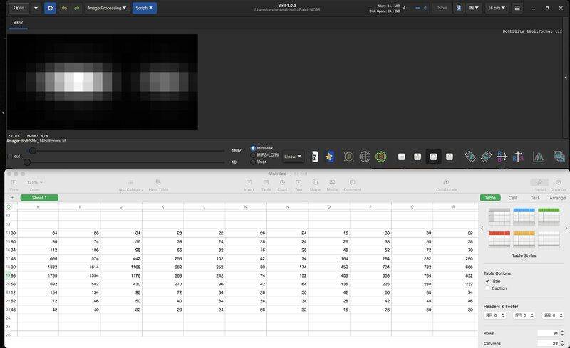

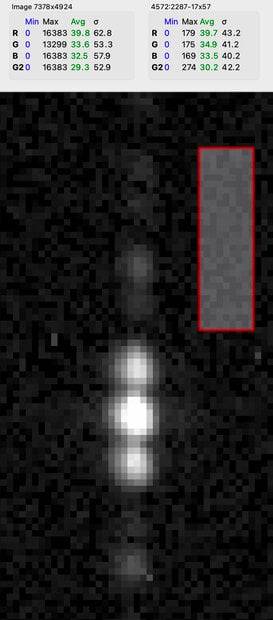

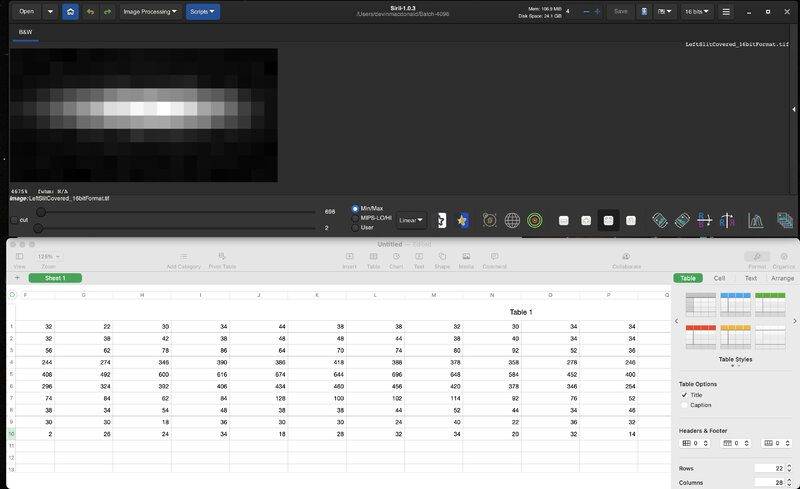

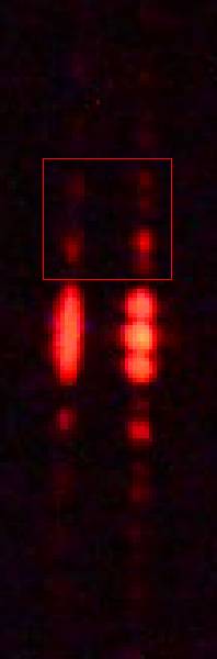

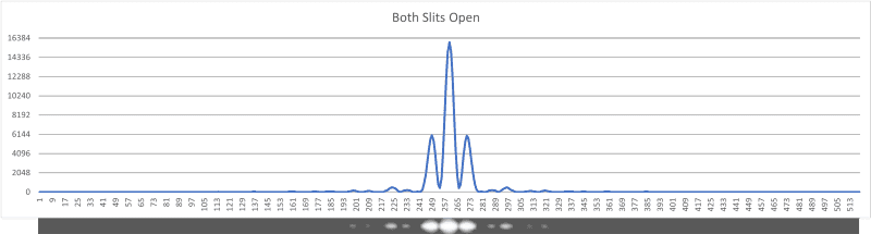

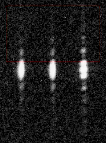

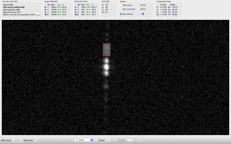

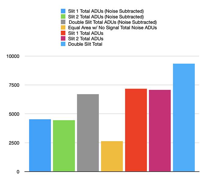

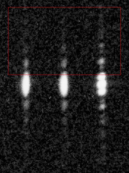

I downloaded a piece of software called RawDigger which lets me inspect the RAW pixel values without needing to first convert the file from RAW (NEF) to TIF. The camera is a Nikon D800 by the way.
I sampled the center most 23x51 (ignoring the green and blue pixels) portion of each diffraction spike and looked at the average red pixel value.
Single Slit Red Average: 2143
Double Slit Red Average: 3537
Same Area Noise Average: 45
Single Slit Red Average Noise Subtracted: 2098
Double Slit Red Average Noise Subtracted: 3492 (1.66x higher)
I would like to do another test with a lower gain setting as a few of the pixels in the center of the double slit pattern saturated (was at 6400iso, want to retest at 1600iso), however I don't expect a break in the clouds for the next 7 days.
  • #45
You can likely do the test inside. A flashlight shining through a tiny hole in a piece of cardboard or thick sheet of paper would probably serve just fine as a point-like source. Of just do away with the paper or cardboard if you don't think you need a point source and point it at the wall or something.

Devin-M said:
Yes the green channel is very close to double, however I don't trust the green (495–570 nm) detections are mostly monochrome light which might be necessary for destructive interference as that light appears to be leaking through the 656nm H-Alpha narrowband filter in front of the sensor.
I think it's more likely that the green pixels are merely picking up red light. I'd bet that the bayer filter on the CCD is letting some of that HA light through the green filters. But I'd have to check the data sheet to be sure.
  • #50
The blue channel double slit is also showing 2.05x the single slit after noise subtraction. But the blue values could also be non-monochromatic leakage through the narrowband filter rather than 656nm HA light activating the blue pixels… It’s very possible the red detections would be much closer to monochromatic overall than the green and blue values.

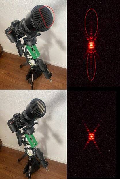

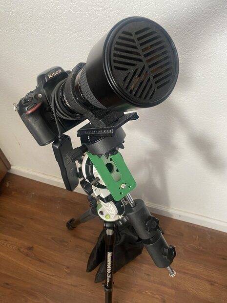

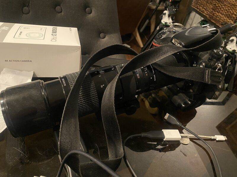

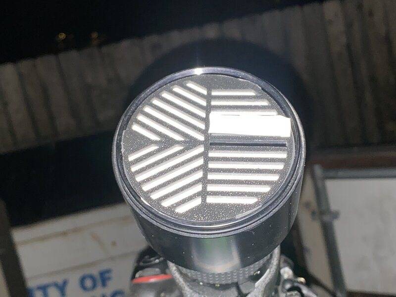

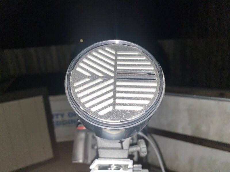

I’m investigating whether situations with high contrast destructive interference give twice the total photon detections with double slit compared to individual slit, or is it less due to the destructive interference.
Here’s my setup Nikon D800 on equatorial mount with H-Alpha narrowband filter in front of sensor, 300mm f/4.5 lens and TC-301 teleconverter for 600mm f/9 doing 5min exposures on Polaris at 6400iso/gain setting:
  • #53
I'm not so sure. Typical HA filters are nearly 100% effective at blocking wavelengths outside of a small range around the central wavelength. However, I believe the green and blue parts of the bayer filter on the Nikon D800 transmit about 5-10% of light at 656 nm.
Likes collinsmark, hutchphd and Dale
  • #54
Devin-M said:
Here’s my setup

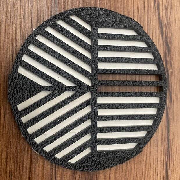

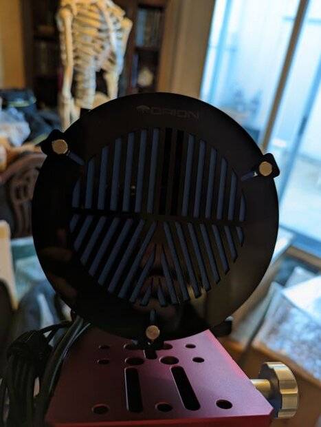

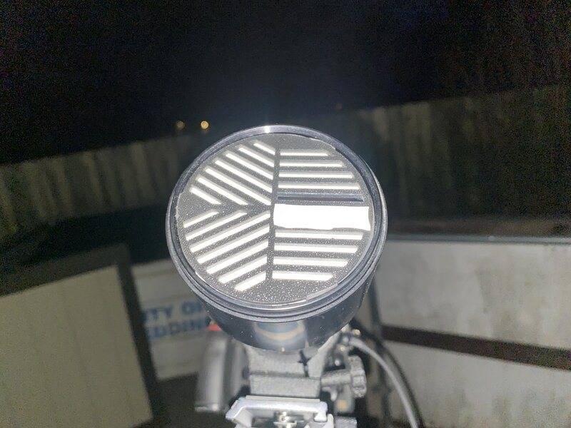

Thanks. Sorry if I am behind the curve here but what is the lens cap with slits?
  • #55
It’s a bahtinov mask, and I’ve blocked off most of the slits with masking tape and then took exposures through each slit separately and then both at the same time in hopes of showing some destructive interference since it’s a monochromatic point source.
  • #56

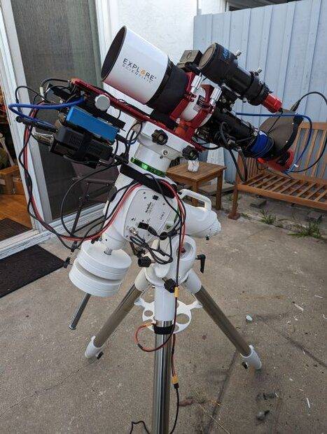

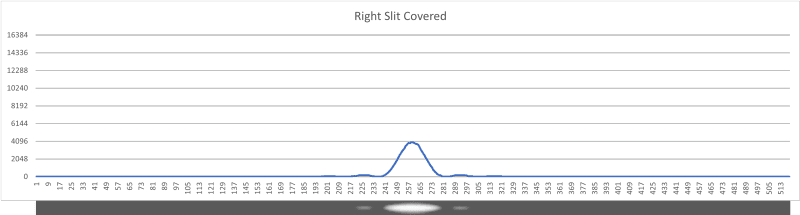

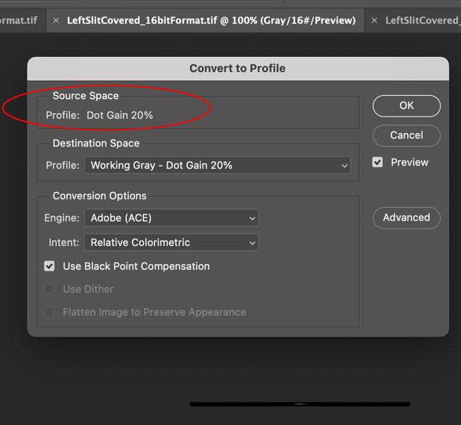

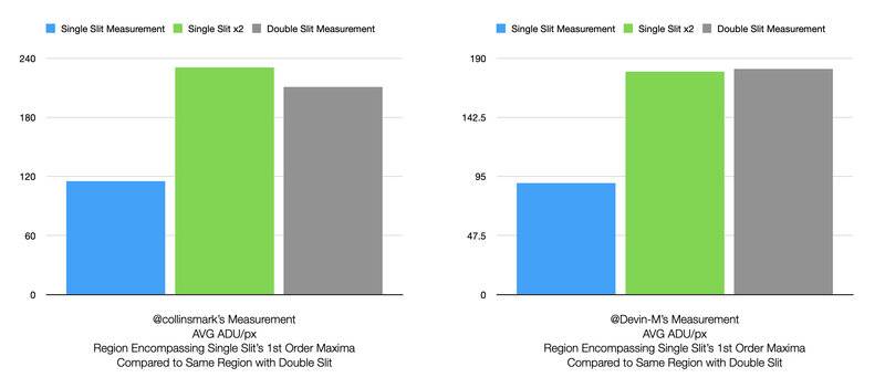

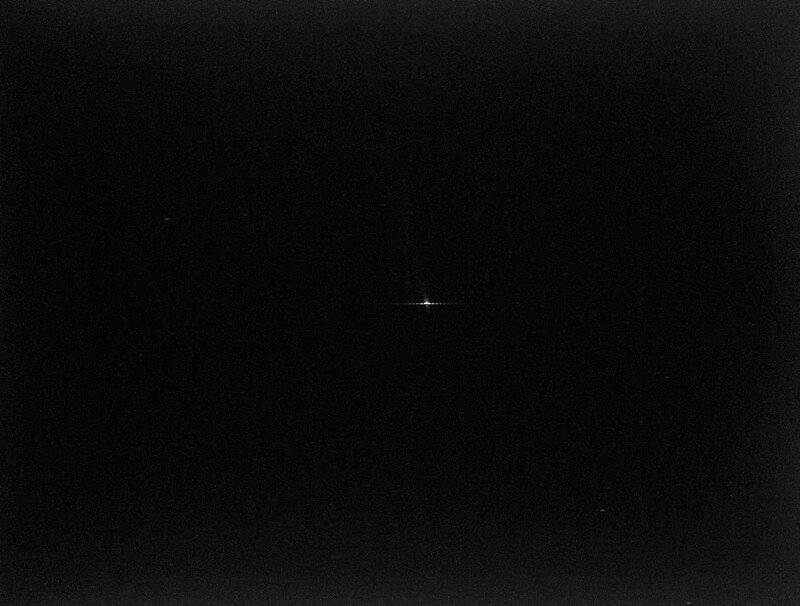

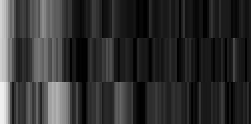

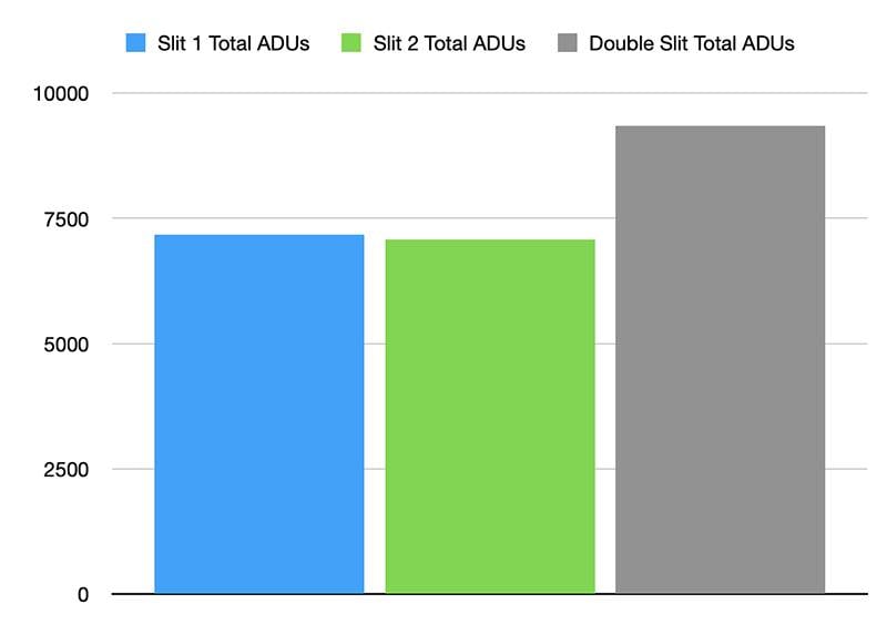

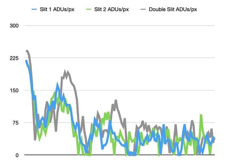

As promised (from post #41), here's my efforts to reproduce the experiment myself.
My Reproduction, Part I: Equipment, Data Acquisition, and Pre-processing
Equipment:
  • Orion Bahtinov mask
  • Blue, painter's tape (essentially masking tape)
  • Explore Scientific ED80-FCD100 telescope
  • Orion Field Flattener for Short Refractors
  • ZWO Electronic Filter Wheel (EFW)
  • An old Astronomik Hα filter (I think it's a ~7nm bandwidth)
  • ZWO ASI1600MM-Pro main camera (monochrome, cooled)
  • Electronic focusing system (Optec and Starlight Instruments mishmash)
  • Orion 50mm Guidescope with Helical focuser
  • ZWO ASI290MM-Mini camera for guidescope
  • Pegasus Astro UPBv2 for power distribution, USB hub, and dew heater control
  • Various dew straps (the good ones are from AstroZap)
  • Various mechanical dovetails, clamps, rings as such from PrimaLuce and ADM.
  • Minisforums (not to be confused with Physics Forums) mini PC
  • Cheapy, Nexigo webcam, just to keep a wide eye on things.
  • Sky-Watcher EQ6-R Pro mount
Figure 1. Equipment setup
Figure 2. Bahtinov mask. Although difficult to see, the entire inside of the Bahtinov mask is blocked out with blue, painters tape except for two of the slits (see vertical slits at the top).
Figure 3. Method for covering left or right slit. It was a simple matter of blocking out a slit by carefully placing a doubled-up strip of blue, painters tape over the top of Bahtinov mask. Or, in the case of both slits open, I just removed the strip and placed it on the table.
Acquisition Details:
  • Target: Aldebaran, because it's bright and was near the zenith at my location (less atmosphere to worry about)
  • Skies were clear
  • Seeing was average
  • ASI1600MM-Pro camera cooled to -10 deg C
  • Camera gain: 139 (offset 50) placing the camera right around unity gain (i.e., ~1 e-/ADU)
  • N.I.N.A. software was used for acquisition along PHD2 for autoguiding
  • Autofocus routine was performed immediately before inserting the Bahtinov mask and acquiring data
  • Left slit was covered and 40, 1.5 sec subframes were taken
  • Both slits were left open and 40, 1.5 sec subframes were taken
  • Right slit was covered and 40, 1.5 sec subframes were taken
  • Bahtinov mask was removed, and lens cover was placed over objective of ES ED80-FCD100 telescope, and 100, 1.5 sec "dark" frames were taken (camera still at -10 deg C)
  • Lens cover removed again, and using a flat panel, 30 "flat" frames were taken. With the lens cover back on again, another 30 "darkflat" frames were taken. However, I didn't end up using flat field calibration on this project (see below)

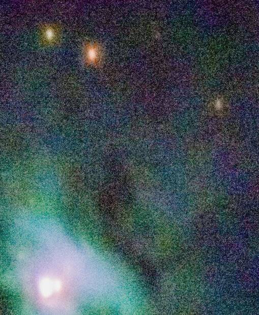

  • PixInsight was used to perform "dark" frame calibration on the "light" frames. This is done by subtracting the master dark frame from each of the "light" frames (i.e., the subframes containing the diffraction/interference pattern) on a pixel by pixel basis. This basically calibrates out the arithmetic mean of the in-camera noise such as thermal noise and read noise.
  • The 40 calibrated frames in each scenario (left slit covered, both slits open, right slit covered) were stacked, using PixInsight.
Figure 4. Example data after dark frame calibration and stacking. Shown here is the image with the left slit covered. Obviously some cropping needs to be done before continuing. (The above image was resized and "stretched" for display purposes here, but the data used in the actual calculations/evaluations did not use resized or stretched images.)

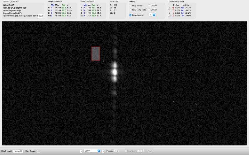

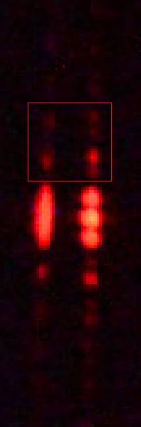

Figs. 5 and 6 show the data after appropriate cropping. In all cases, the crop was 519 pixels wide by 10 pixels high.
Figure 5. Data after cropping. From top to bottom: Left slit covered, Right slit covered, Both slits open.
Figure 6. Same data as Fig. 5, but with a "stretch" so it's easier to see the details. (Note: Stretching was done for display purposes only: forthcoming calculations were done based on unstreched data.) From top to bottom: Left slit covered, Right slit covered, Both slits open.

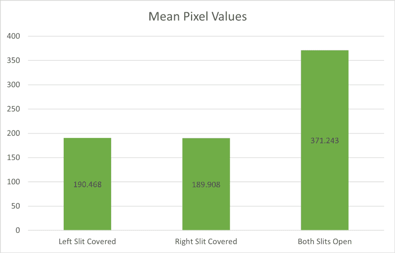

Now that we have nice crops, all we need to do is add up or average the pixels values in each scenario. PixInsight has an easy way to do this using the Statistics process, where it gives you the arithmetic mean of the pixel values in a given image. So that is what I used.
Arithmetic mean pixel value, Left Slit Covered: 190.468
Arithmetic mean pixel value, Right Slit Covered: 189.908
Arithmetic mean pixel value, Both Slits Open: 371.243
Figure 7: Results
According to ideal theory, the average pixel value with both slits open should be quite close to twice the average value of a single slit. Or if the slits are of slightly different size, the value with both slits open should be about the same as the single slit values added together.
Sum of single slit values:
190.468 + 189.908 = 380.376
So, my results differ from theory by about
\frac{380.376 - 371.243}{380.376} = 2.4 \%
I'd say 2.4% ain't bad, and is within my own margin of experimental error. I expect I could have even done better with more careful cropping.
So I'm going to be so bold as to claim that my results pretty much agree with theory (more-or-less).

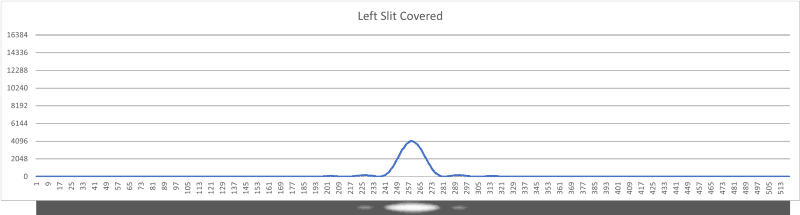

I also wrote a C# program that sums all the pixel values together in each column to be used for plotting the 1-dimensional spacial results. Here are the resulting plots:
Figure 8: Both slits open plot.
Figure 9: Left slit covered plot.
Figure 10: Right slit covered plot.
The shapes of the diffraction/interference patterns also agree with theory.
Notice the central peak of the both slits open plot is interestingly 4 times as high as either single slit plot. Yes, this agrees with theory and can be explained using classical theory or by quantum theory.
In the classical approach, the intensity of an electromagnetic wave is proportional to the square the amplitude of the electric field. So if you have two waves constructively interfering (doubling the electric field amplitude), the intensity increases by 2^2 = 4.
As others have pointed out, quantum theory is not necessary to explain the shapes. But you could use quantum theory if you really wanted to. If you did you'd find the probability density of a photon landing exactly on the central peak is approximately twice that for the double slit configuration than it is for the single slit configuration. So that's a factor of 2 right there from the probability. The other factor of 2 comes from the fact that there's two slits open in the double slit scenario, so twice as many photons arrive at the detector compared to only 1 slit open. And that's the other factor of 2. So 2 \times 2 = 4.
In any case, even though the central peak is 4 times as large in the both slits open scenario, the area under the curve is only twice as large, in part due to more frequent regions of destructive interference.
And that's about all I have on this.

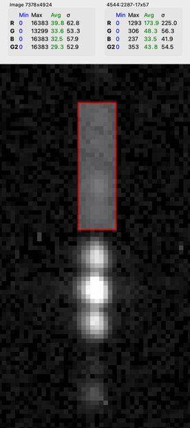

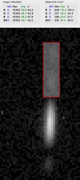

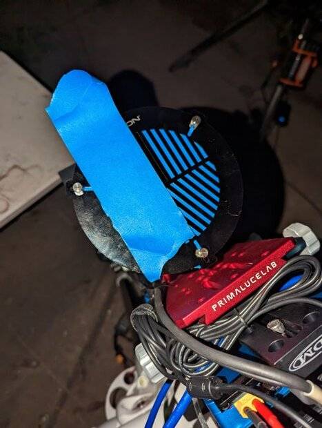

I performed a new test, this time where I measured each slit individually, and then both at the same time:
Slit 1 ADUs: 7165
Slit 2 ADUs: 7076
Double Slit ADUs: 9339
Each test was targeting the star Polaris with a 5 minute exposure, 600mm, f/9, 6400iso, with a H-Alpha narrowband filter (656nm) in front of the sensor on a Nikon D800 DSLR, and the camera was mounted on an equatorial mount to compensate for the Earth's rotation.
Devin-M said:

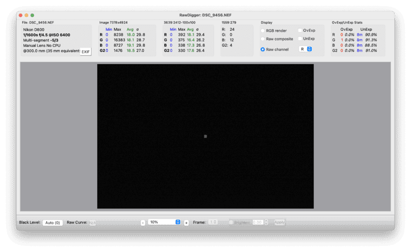

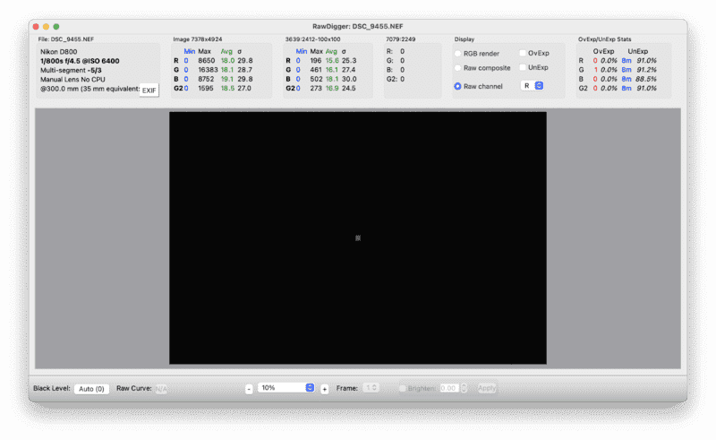

I've now (at your suggestion) looked at how much noise is in equal area with no signal...
Noise ADUs in area w/ no signal: 2634
Slit 1 ADUs w/ noise subtracted: 4531
Slit 2 ADUs w/ noise subtracted: 4442
Double Slit ADUs w/ noise subtracted: 6705 (1.47x higher than slit 1)
Noise Sample:
