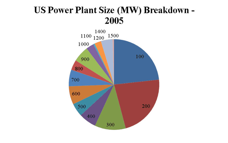

More EIA plant size slicing:
Attached pie chart for all ~16000 US power sources, of all types, broken out in 100MW increments.
Here's the associated breakout numbers in GW, (100MW increments)
0-100MW: 248.2GW, 23.3%
<200: 240.9, 22.6%
<300: 118.3, 11.1%
<400: 66.4, 6.2%
<500: 50.6, 4.7%
<600: 69.4, 6.5%
<700: 63.1, 5.9%
<800: 38.8, 3.6%
<900: 61.0, 5.7%
<1000: 29.9, 2.8%
<1100: 5.2, 0.5%
<1200: 25.5, 2.4%
<1300: 44.2, 4.1%
<1400: 5.6, 0.5%
Total US nameplate capacity 1067GW
