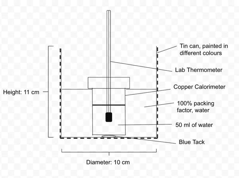

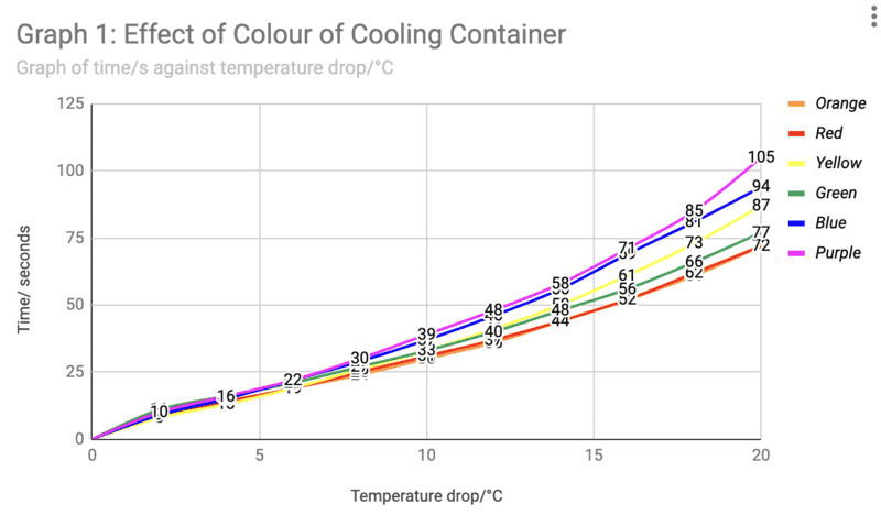

I did this experiment 2 years ago when I was in 10th grade. It was done under white light. I realize my recollection was not perfect, resulting in errors in my description. Attached below are the results and the setup.
@hutchphd , yes the results seem statistically significant.
What is the container sitting on? Is it under normal room lighting? What kind of lights? What time of day? How well is room temperature controlled? Was it the same can painted multiple times or different cans? Sitting next to each other or tested separately? Was the entire apparatus heated to 100C or was boiling water poured in at the start? Was any attempt made to predict or explain the results quantitatively? I notice the can is uncovered...
The results do seem statistically relevant, but there is a lot of room for error. There's also a few simple variants that could be tried to account for the errors. Like insulating and/or covering it. And trying bare tin, black paint and silver paint.
Edit: wait, the graph is presented rotated 90 degrees from what one would typically see, which makes it hard to read, but aren't the results backwards from what theory would predict? What exactly was the prediction and conclusion here?

The container is sitting on a kitchen top. I think it is marble. Yes, it is under normal room lighting, white light. I did this at night. Room temperature was around 28 degrees Celsius. There were 7 different cans, painted with 7 different colours. Tested separately, 1 by 1. The 20 degree drop, for all 7 cans, was from 70 to 50. Recording did not start until the water was 70 degrees Celsius. The can is uncovered, but the water is held in the covered calorimeter. If you are wondering why water surrounds the calorimeter, that is because the assignment was to design a can that cools water in the calorimeter by 20 degrees Celsius in the shortest possible time. Colour of can was just 1 of the 4-5 factors investigated, other factors include medium surrounding the calorimeter, starting temp of water, volume of medium surrounding water etc. Because I was testing colour, I kept the material surrounding the calorimeter (water) constant. My group was able to come up with reasonable explanations for all the other factors; colour was the only factor We couldn’t explain. The explanation we ended up giving was using Wien’s displacement law, but I myself am not convinced given the fact that the law only applies at very high temperature. (A few thousand Kelvins). Unfortunately, we did not investigate black, as black was explicitly prohibited. We thought silver was reflective and would reflect heat back into the calorimeter, so we eliminated silver too.
The conclusion is that red was the most effective colour. This conclusion is contentious. This project was a school wide science performance task that was graded, and most groups were split between purple and red, although I think more groups found red to be the most effective colour.
for the entire project, to make the most effective cooling device, we used a red can, water in calorimeter with starting temperature 90 degrees (maximum allowed starting temperature, temperatures > 90 were explicitly banned), the medium surrounding the calorimeter was vinegar, and vinegar was filled to the maximum height of the calorimeter.

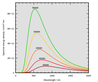

The 'photograph' is from Wiki Wien displacement law - for black body radiation.
And if radiative power is related to the color of the object, or temperature, then we see that a blue object ( of the emmissive wavelength blue - not reflected blue ) radiates more power than a similar object of green, yellow, or red color. ( ~ T4 )
Since your object is only painted a certain color of the visible spectrum, it does not follow that Wien law would not apply to the color seen.
Your object I would suspect is selective - it reflects ( as stated by Russ ) the colour red of the visible spectrum, and it might not exhibit a black body radiation even at the temperature of it is at ( 300 K or so ).
