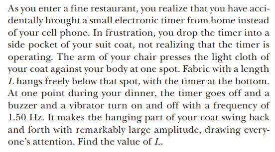

member 731016
Please see below
Please see below
For this problem,
How do we tell when the buzzer vibrates during the cycle to provide the driving force?
Many thanks!
It's an example of resonance. https://en.wikipedia.org/wiki/Resonance.
Because there are losses in the swinging cloth, it will always be a bit behind the source of vibration (phase lag). As a result, the impetus from the source is reinforcing.
Likes member 731016
Thank you for your reply @haruspex !
