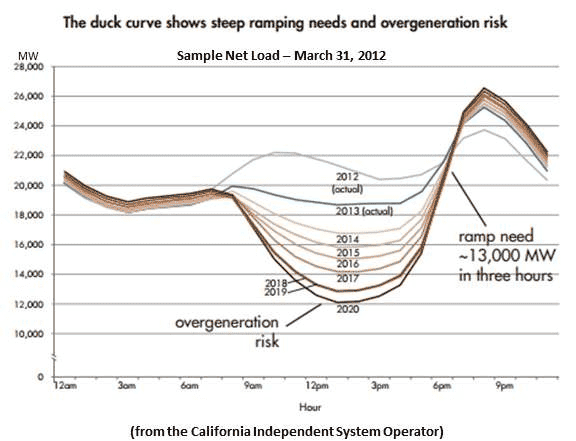

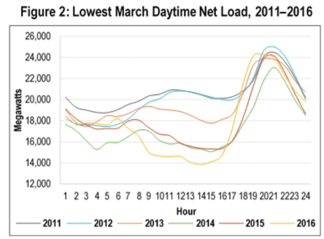

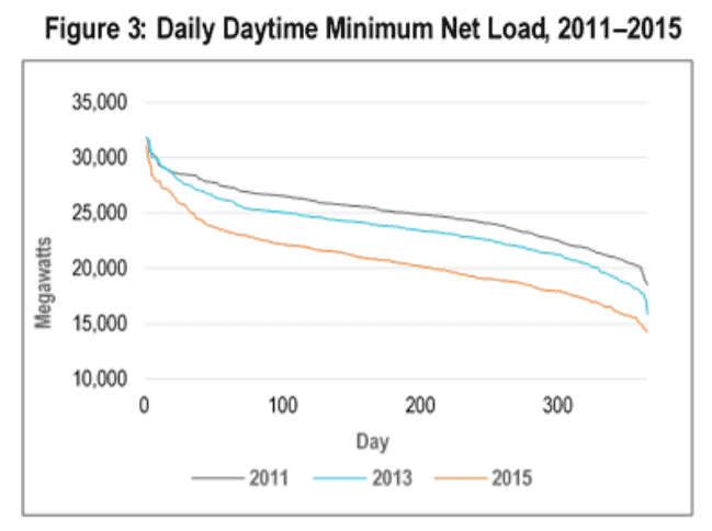

Additionally, I think the grid load issue maybe a bit overstated, (at least for the present) because the majority of BEV users have home chargers that are used during the low overnight peak power consumption period and with the current expansion of BEV mileages do not require any added daytime or evening additional charging.
Well, sure, the downsides of an insignificant thing tend to be insignificant. But isn't the goal here to make the impact of EVs significant? If that's the case, then you have to take the significant downside along with the significant upside -- you can't have one without the other. Converting a significant fraction of cars to EVs without increasing pollution will require a significant increase in the number of power plants capable of providing clean energy, with flexibility to provide a significant amount of it day or night, in good weather or bad.
Many municipalities in California are aiming to go a step further by banning natural gas for new construction, with the eventual goal of phasing it out (it will take maybe 30 years). If that happens, then the grid will peak at night, during the winter, maximizing the collective downsides of EVs and intermittent renewable energy. That's a big, big problem that they are planning to cause, with no plan to solve it. Then we'll be arguing if 3.0 COP heat pumps powered by natural 45% efficient natural gas power plants are better or worse than 95% efficient natural gas furnaces and nothing will have actually changed emissions-wise.
That's why it is so important to address the grid first.

DEvens said:
If battery farms could be made to handle even a few percent of the total load they could make the mid-day bulge smaller and the middle-of-the-night trough less deep. And that would be good for nuclear as well.
Have you seen what has been having in Southern California recently because of solar. The number of events with negative prices in the afternoons is increasing.
  • #32
You make that sound like a bad thing. Why? Lots of things have positive value at a certain place and time and a negative value at others. (Water, for example)
This is a projection from 2013? What is the y axis? Certainly not total demand. Demand minus renewables?
  • #34
It is historical data. The Y axis is power delivered by the grid. It dips in the afternoon because of solar power produced and consumed inside the home that is not metered and that does not flow through the grid. So yes it is demand; demand for purchased electricity, distinct from consumed electricity. Total demand can no longer be metered.
