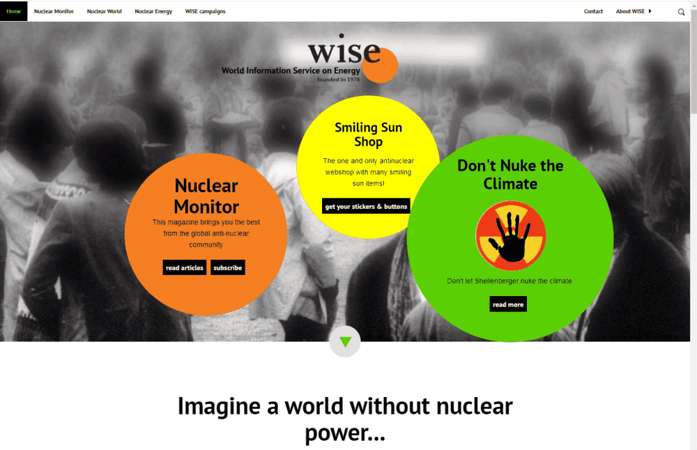

Tghu Verd said:
You've emotive terms here - 'chicken' and 'properly' - in an assertion, not an evidence-based statement. A number of studies have found no evident basis for SMRs, which are intentionally 'industrialized' nuclear fission designs, to radically drive down the cost of electricity production. I like Jim Green's overview of the current state because he provides a nice summary of many reviews with links to the underlying references and that's my pointer to 'many studies'.
that wiseinternational.org link might be a little biased? Have a look at the front page, can you tell? It calls itself an "antinuclear webstop!", not sure, but they may not like nuclear. Perhaps for emotive reasons?
Then Jim Green is an anti nuclear activist:
https://en.wikipedia.org/wiki/Jim_Green_(activist)
Hardly someone who would actually look for positive signs, instead, far more likely he will cherry pick things that support his position.
