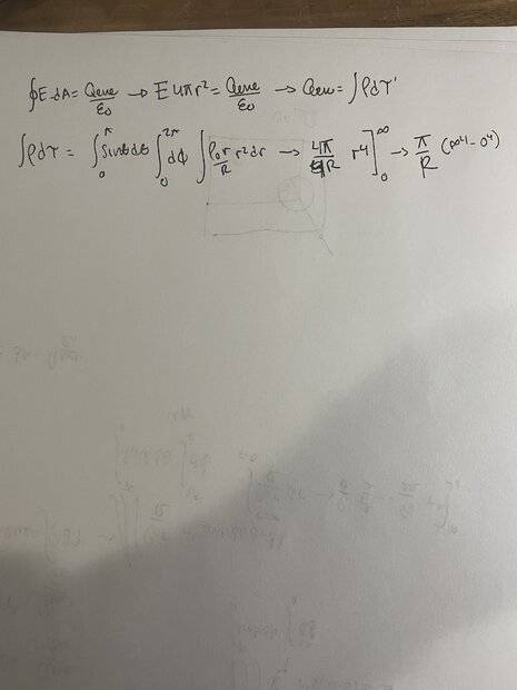

A sphere with radius R has a volume charge density
ρ = ρ0 𝑟⁄𝑅, where ρ0 is constant.
Find the electric field as a function of r, from r=0 to infinity.
Eda=qenc/epsilon
Im having trouble understanding the wording to this problem. When it says "from r=0 to r=infinity". My Qenc would zero out. I guess it makes sense that from infinitely far away you wouldn't "feel' the electric field but considering this question leads to 4 other questions I don't think I am approaching this right.
Can anyone help me understand this a little better?
What do you mean with that ?
##Q_{\rm enc}## is zero for ##r=0## only. It increases with ##r## until ##r=R## and then it stays the same -- all the way.

I was referring to integrating the r on the last step of my work.
But i think i understand what the question is really asking based off what you said. I am basically evaluating the electric field at r=0, r=R ? Past R the electric field is constant.
But what would my limits be for the r component of Qenc?
The electric field is not constant for r > R, rather ##Q_\text{Enc} ## is constant for r > R .
You need to integrate the charge density to find the charge enclosed within a sphere of radius r, where
0 < r ≤ R .
Sorry, I think the wording just completely threw me off. I understand what the questions is asking now. I just confused myself really bad.
