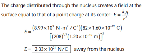

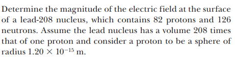

For this problem,
The solution is,
However why is ## r = (208)^{1/3}(1.20 \times 10^{-15} m)##
Many thanks!
Just write the relationship given, between the volume of proton and volume of nucleus in terms of the respective radius. (##V=208 V_p##).
Likes member 731016
Thanks for your reply @nasu!
I will use ##r## for the radius of the nucleus and ##R## for the radius of the proton.
## \frac {4{\pi}r^3} {3} = 208\frac {4{\pi}R^3} {3}##
## r =(208R^3)^{1/3}##
## r = 208^{1/3}R ##
## r = (208)^{1/3}(1.20 \times 10^{-15} ## ##m)##
Thank you I see how they got it now!
Likes berkeman and nasu
