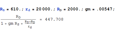

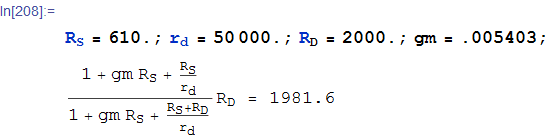

Now, if we substitute numerical values into the expressions, we get:
and:
The numerical evaluations are very different; the second is not even a very good approximation to the first.

He doesn't show how he got the original expression but he does this see attached.
when i solved for VGS i got -0.974 V and gm = 5.403 mS
but this
[itex]Z_{O} = \frac{1 + g_{m}R_{S} + \frac{R_{S}}{r+{d}}}{1 + g_{m}R_{S} + \frac{R_{S} + R_{D}}{r_{d}}}R_{D}[/itex]
gives me 1730.826
but this
gives me 1730.826
What values did you use for Rs, rd, and RD?
When I use these values, I get:
