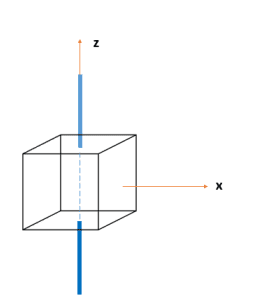

Consider a rod with an electric charge density λ that passes through the center of the cube. Prove that the electric flux passing through this cube is equal to = q / ε0
Gauss's law
Picture for better understanding.

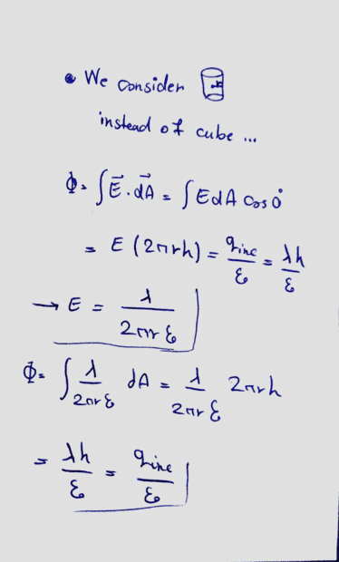

My answer :
I want to know how to solve this problem without using cylindrical. I mean how can we solve this using cube and its sides.
What about your relevant equation ?
Thank you ... but what do you mean by relevant equation?
Does your relevant equation worry about the shape of the surface ?
[edit]On the other hand,
could be interpreted as an invitation to show that for this case the gauss identity holds. In that case you could actually integrate the flux: you know the electric field (right?) and can benefit from symmetry.
I guess no it doesn't ... Thank you for your help ...
