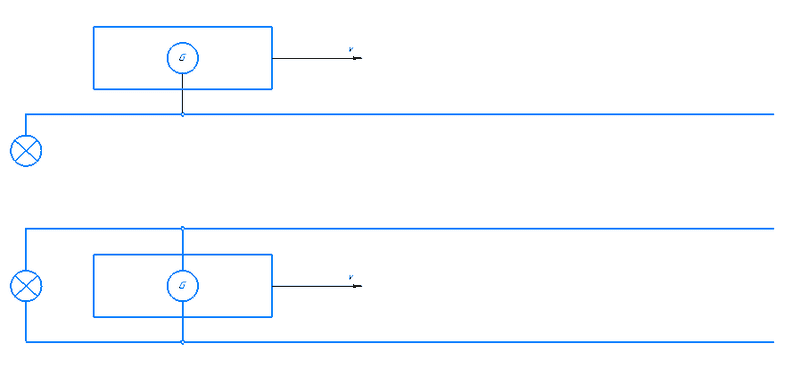

I am interested in a question related to energy for different reference frames. Let's say we have two inertial reference frames A and B. The reference frame B moves relative to the reference frame A at a high speed at which relativistic effects are manifested. In reference frame B there is a diesel electric generator that operates and outputs a power of 2200VA, voltage 220V, current 10A. The terminals of this generator are connected using wires and sliding contacts to the reference frame A, which contains a load of 2200VA, 220V, 10A.
According to the special theory of relativity, for reference frames A and B, there is a relativity of simultaneity, that is, time slows down in the moving reference frame B. In this case, reference frames A and B are connected by an electric circuit, the processes in which occur at the speed of light, that is, at the maximum possible speed, the same for all reference frames.
Is it true that the following results are obtained? An observer in the frame of reference A (load) sees in the frame of reference B a generator that runs slower (consumes less fuel), but at the same time outputs power, voltage and current, as in normal operation. The observer in reference frame B sees in his own reference frame a normally operating generator that consumes a normal amount of fuel and outputs normal power, voltage and current. After returning to the frame of reference A, this observer discovers that the generator, which worked for him for 1 day, supplied energy to the frame of reference A for 2 days. Are these correct?

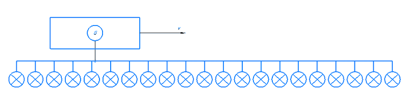

I agree with you. You can change the model a bit. Let's say there is a laboratory with which the reference frame A is connected and there is an object, for example, a capsule, which moves relative to the laboratory and with which the reference frame B is connected.

To answer your actual question, I suspect that your setup is contradictory. You have a generator that produces some amount of power as measured in its own rest trame, and a load that consumes that amount of power in its own reference frame. With special relativity in play, the two devices see each other time dilated, so don't measure the same power production/consumption as in the devices' respective rest frames. So your scenario can't work as described.
The generator is located in a moving capsule. The capsule is connected to the laboratory by means of wires and sliding contacts. The load is in the laboratory. That is, a process is obtained in which, on the one hand, there is a time dilation between the capsule and the laboratory, and on the other hand, the capsule and the laboratory are connected by an electrical circuit, in which processes occur simultaneously for the capsule and the laboratory.

Let's say the laboratory is a very long building with two rails installed on the roof. A load, such as an incandescent lamp, is connected to these rails. A capsule is flying relative to the laboratory, inside of which there is a diesel generator. Wires are stretched from the capsule to the laboratory rails, which are connected through sliding contacts. It is quite possible to create such a model in reality.

The first thing to think about is the changing distance between the generator and the load. That on its own means that the absorbed power is different from the emitted power. Also, you will need to factor in the different energy content of the fuel in the two frames.
The distance between the rails and the capsule does not change. How can the energy of diesel fuel change during the transition to the reference frame B? Relativistic mass increase, linear size reduction, time dilation?
The distance between the generator and the load does, though.

The capsule moves parallel to the rails and the distance between them does not change. The load, an incandescent lamp, is connected to the rails and such a system, in fact, is an ordinary electric line.
This all sounds like a red shifted photon to me, but with a bunch of complex hardware. No?
Either the load is moving relative to the generator or it isn't. In the first case the distance between the load and generator must be changing. In the other case, they're at rest in the same frame.

The load is an incandescent lamp connected to the rails. The distance between the rails and the capsule does not change. The rails are structurally part of the load.
View attachment 356680 The load is an incandescent lamp connected to the rails. The distance between the rails and the capsule does not change. The rails are structurally part of the load.
That's not exactly irrelevant, but it's far less important than the fact that the distance between the source and the load DOES change.

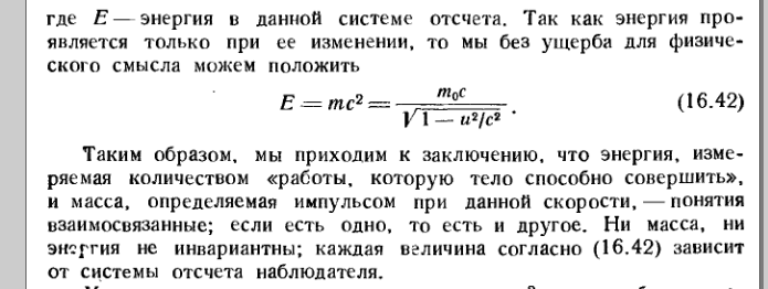

  • #31
Excuse me if I misunderstand something, but in this book, on page 295, it literally says the following: "Since energy manifests itself only when it changes, we can put it without prejudice to the physical meaning.:
Thus, we come to the conclusion that energy, measured by the amount of "work that a body is capable of doing," and mass, determined by momentum at a given speed, are interrelated concepts. If there is one, then there is another. Neither mass nor energy are invariant; each quantity, according to (16.42), depends on the observer's frame of reference."
  • #32
It seems to me that the following conclusion can be drawn from this statement. If the energy depends on the reference frame, then the energy in the capsule (reference frame B) differs from what energy an observer in the laboratory identifies in it (reference frame A). If two reference frames are connected by a process occurring at the speed of light, which is equal for all reference frames, then the energy of the reference frame B can be obtained in the reference frame A...
