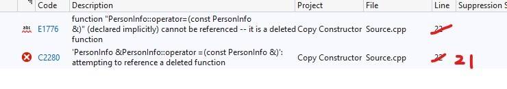

Can anyone help me why I have an error on this? I simplified the program to the barebone:

I had this program, it was working, I don't see any problem. I am blind on this, it's supposed to be simple!
You have a copy constructor, but you don't have an overloaded assignment operator; i.e., operator=().
The line clone = bob;//copy constructor needs to have operator=(), but you didn't write one.
Also, your comment is wrong -- this line is not calling a copy constructor. A wrong comment is worse than no comment at all.
Also, your code doesn't use Nsize, so why is it there? Even if there is a good reason, it shouldn't be const int in the class definition.

yungman said:
It's really funny, I have it in my notes that actually ran the program, you can see I can do immediate window. You look at the code, there's no assignment operator. That's where I got tripped. It obviously was working, I got everything.
The part of your code where you show the immediate window doesn't also show main(), so I'm not certain you ran the code you showed a few posts back. The part with main() is below the screen shot with the immediate window. That part also has the same incorrect comment -- "clone = bob;//copy constructor"
Again, this code assumes that you have an overloaded assignment operator -- you don't.
I believe the code you showed a few posts back. I don't believe that the code you have in your notes actually ran without error.

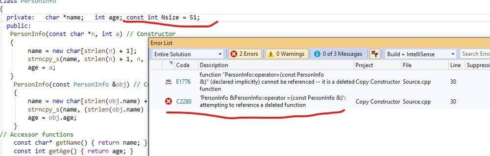

Hi
I am really out of idea. This is the program I am experimenting. I put const int Nsize = 51; into comment, then it will run. It gave me

The abort info is this, but you can see the result is out and is correct:
But if I put const int Nsize = 51 back in as shown, it will give me this error:
I don't know how to explain. I am not saying that I don't need operator=(), like Mark suggested. I just want to know why I went this far without it, but adding const int Nsize = 51 blows up everything.
I did make it one code line per line. I just too stuck with the problem.

  • #50
Solution is defining operator=.
Explanation: Like Mark pointed out, line 29 is not calling the copy constructor, it's calling operator=. You didn't define an operator=, so it would use the default one, which just does a shallow copy. Then when both copies go out of scope, they each call delete on the same memory address (in their destructors), which is why you get that runtime error (you should never call delete on the same address twice).
The reason it doesn't compile in the uncommented version is that C++ will "delete"
the default operator= in certain cases, forcing you to either define it yourself or not use it. Having a const member happens to be one of those conditions, as you can see in the below link under the section quoted,
Deleted implicitly-declared copy assignment operator
A implicitly-declared copy assignment operator for class T is defined as deleted if any of the following is true:
  • T has a user-declared move constructor;
  • T has a user-declared move assignment operator.
Otherwise, it is defined as defaulted.
A defaulted copy assignment operator for class T is defined as deleted if any of the following is true:
  • T has a non-static data member of non-class type (or array thereof) that is const;
  • T has a non-static data member of a reference type;
  • T has a non-static data member or a direct or virtual base class that cannot be copy-assigned (overload resolution for the copy assignment fails, or selects a deleted or inaccessible function);
  • T is a union-like class, and has a variant member whose corresponding assignment operator is non-trivial.
https://en.cppreference.com/w/cpp/language/copy_assignment

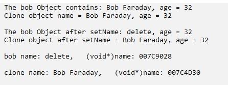

I put in the operator=() and it works. Don't understand why it worked so far without the operator=().
This is the program:
C++:
// This program demonstrates the copy constructor
#include <iostream>
#include <cstring>
using namespace std;
class PersonInfo
{ private:     char* name;  int age; const int Nsize = 51;
  public:
   PersonInfo(const char* n, int a) // Constructor
{   name = new char[Nsize];
   strncpy_s(name, Nsize, n, Nsize) ;  age = a;}
  PersonInfo(const PersonInfo &obj) // Copy Constructor
   {name = new char[Nsize];
   strncpy_s(name, Nsize, obj.name, Nsize);
   age = obj.age;
   PersonInfo& operator=(const PersonInfo& rhs)
       strncpy_s(name, Nsize, rhs.name, Nsize);
       age = rhs.age;
       return *this;
// Accessor functions
  const char *getName() { return name; }
   const int getAge()  { return age; }
   const void printB() { cout << " bob name: " << name
       << ",   (void*)name: " << (void*)name << "\n\n"; }
   const void printC() { cout << " clone name: " << name <<
       ",   (void*)name: " << (void*)name<< "\n\n"; }
   void setName() { strncpy_s(name, Nsize, "delete", Nsize); }
   ~PersonInfo() { delete[] name; }
int main()
{    PersonInfo bob("Bob Faraday", 32);
    PersonInfo clone("clone", 44);
    cout << " The bob Object contains: " << bob.getName() <<
        ", age = " << bob.getAge() << endl;
    cout << " Clone object name = " << clone.getName() <<
        ", age = " << clone.getAge() << "\n\n";
    bob.setName();
    cout << " The bob Object after setName: " << bob.getName() <<
    cout << " Clone object after setName = " << clone.getName() <<
    bob.printB();
    clone.printC();
    return 0;
This is the printout from the program:
maybe it's time to move on instead of keep asking why, just follow the rule of Three.
Thanks Mark, Jarvis323 and Sysprog.
Thanks

I finished updating my notes on Constructor and Copy Constructor. Here is the copy of this part of my notes. Obviously I really packed the lines to make the code take up less space. It's for my own notes.
Thanks

The notes still have incorrect comments.
int main(){ PersonInfo bob("Bob Far", 32); PersonInfo clone("clone", 44); clone = bob;//copy constructor
bob.setName();//After copying clone = bob, change name of bob and see what happen to clone
bob.printB(); clone.printC(); return 0;}
The line clone = bob; is NOT calling a copy constructor. For about the fourth time, this code calls operator=().
The second highlighted comment above implies that you think clone changed because of a copy constructor.
