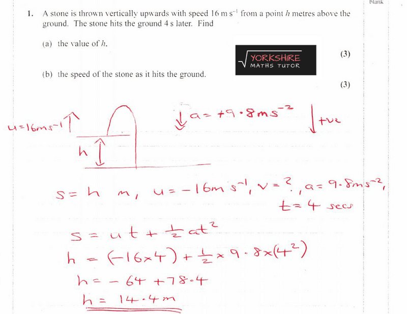

See attached.
kinematics
Was the approach used by the referenced tutor correct?
In my understanding, the set up equation ought to be,
##s=-h, u=16## as the stone is being thrown upwards and ##g=-9.8##
giving me,
##-h = 64 - \dfrac{1}{2}×9.8 ×16##
##-h=-14.4##m
##h=14.4##m , or it does not really matter.
Your tutor used a sign convention where downwards is positive.
You used a sign convention where upwards is positive.
You both solved the problem correctly and got the same answer.
One approach isn't better than the other IMO.
Edit: technically it would be better to round the final answer to 2 significant figures, for consistency with the given data.
Likes MatinSAR, DeBangis21 and chwala
Not my tutor though ... the term 'tutor' was in reference to the attached downloaded pdf. Cheers though.

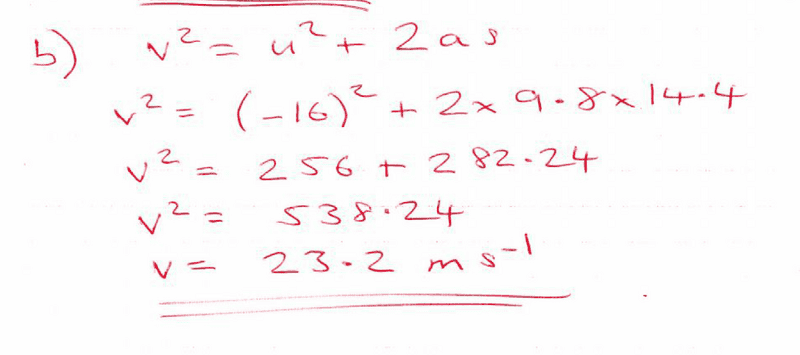

For part (b) this is clear,
but i can also use,
##v=u + at##
##v= 0 + 9.8(4-1.63265) = 23.2## m/s
I made use of ##\dfrac{ds}{dt}##, just incase the question on ##1.63## comes up.
cheers.
but i can also use,
##v=u + at##
Or even:
##v = u + at = 16 + (-9.8) \times 4 =-23.2## m/s
Speed = |v| = 23.2 m/s
Likes MatinSAR and chwala

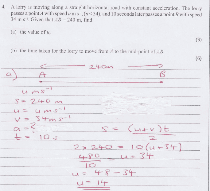

This is a related problem, allow me to post it here rather than start a new post;
The steps are clear;
also we could solve it by simultaneous equation, that is by use of velocity and distance formula (suvat), we shall have the simultaneous,
##34=u+10a##
##480=20u+100a##
##u=14## m/s.
