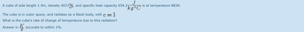

see attached
dQ/dt=Ae*5.67E-8*T^4
So first I found rate of heat change using the above equation, with T=883K, e=1, SA= 6*l^2=21.66
Now dQ/dt=746593.71 W
Now I am not sure entirely what to do next. They give density so I likely have to get the mass from that, M=pV,=1.9^3*4037=27689.783 kg.
My issue is that I don't know how to relate change in heat to h=change in temperature.
I could try Q=mc(change in T). But I have change in Q, not Q. Not sure how I would integrate dQ/dT either...
Answer is -0.04121 btw.

What is the definition of specific heat capacity? Might be relevant...
You have Q = mcΔT. Let Δt be the time interval corresponding to the change in temperature ΔT. Think about the equation that you get by dividing both sides of Q = mcΔT by Δt. For small Δt, how does the left side relate to dQ/dt?
So I can find dQ/dt using dQ/dt=A*5.67E-8*T^4
I can find m using m=pV
And I know Q=mc(change in T)
But dQ/dt isn't Q. Or can I just put it in the equation anyways and solve for change in T and it will work?
$$\frac{dQ}{dt}=mc\frac{dT}{dt}$$
