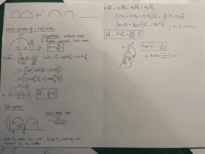

Find center of mass of a arc (letter B)
x_com = \frac{m_1 x_1 + m_2 x_2}{m_1+m_2}

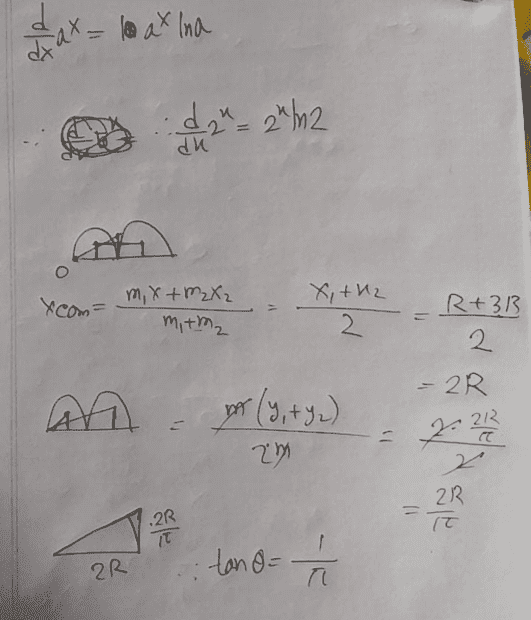

In my mind, I had cut half of B and, thought it's semi-circle. Then, I was trying to find Center of Mass by taking it as semi-circle. But, I get an answer which is approximately, close to main answer. Someone else had solved it another way
This way I can get the accurate answer. But, the picture is very blurry that's why I can't understand it. Why both answers aren't same? Is there any other way to calculate Center of Mass?

Your solution seems to have ignored the mass of the upright line in "B".
Which solution? I had attached two pictures. One is done by me (my friend) and, another had done by another person in Internet..
Yes your solution (first picture in the OP) doesn't take into account the "base line" of "B", that is the segment that consists of the diameters of the two semicircles and has total length 4r.
