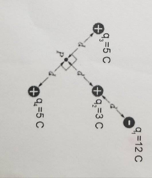

Calculate the net electric field at point P from the diagram below
E=(kq)/r^2
Where k is plank's constant 9×10^9
R= distance or radius
Since q3=q4 and they are opposite to each others they cancel out
But as soon as I try to find the electric field of one of the charges, I need the radius which is not given.
By isolating the electric field for radius
E=(kq)/r^2
I now have two unknowns
Can you post the full problem statement as it was given? (k is Coulomb's constant, not Planck's constant.)
NotInMrPutmansClass said:
Homework Statement:: Calculate the net electric field at point P from the diagram below
Relevant Equations:: E=(kq)/r^2
What radius is this? You are given the positions of all charges relative to the point of interest P which is all you need to find the electric field at P. If you are not given a numerical value for distance ##d##, then leave it as ##d## in your answer.
