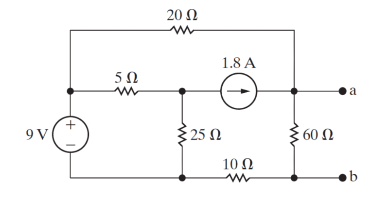

Find the Norton equivalent resistance
Sum of resistance in a parallel circuit: 1/Rt = 1/R1 + 1/R2...
Sum of resistance a series circuit: Rt= R1+R2...
Don't know where to go from here:

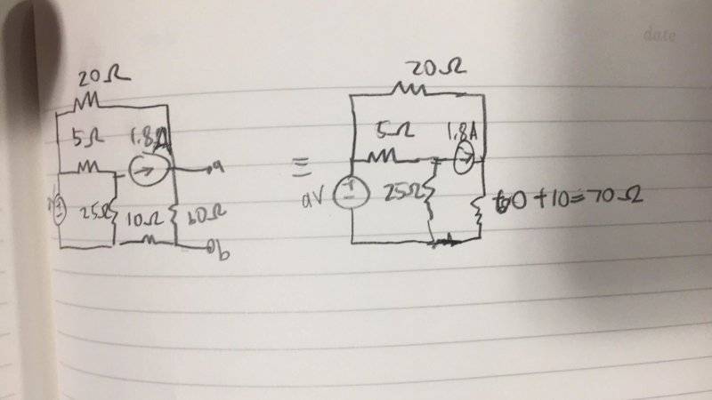

Actually, I believe this might be the solution. Is this correct?
51795511_331039977514846_8117870441529344_n.jpg?_nc_cat=102&_nc_ht=scontent.fyyc3-1.jpg
  • 51795511_331039977514846_8117870441529344_n.jpg?_nc_cat=102&_nc_ht=scontent.fyyc3-1.jpg
Well I see you got a start and eliminated the Voltage and Current sources. However I can't tell if those sources were replaced by Shorts or Opens. Can you clarify with a better schematic?
