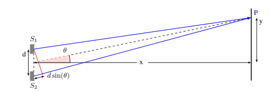

Find the phase difference in terms of d, lambda, theta

Referring to Figure 4.8, what is the phase difference φ between S¯1 and S¯2 in terms of d,
θ and λ.
See attached image.
So in figure 4.8 the path difference between the two waves is d*sin(theta), then is the phase difference just (d*sin(theta)*2*pi)/lambda?
This is a good approximation for the path difference when ##d << x##.
Yes
