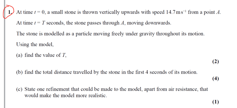

Find the value of ##T## and distance of particle in the first ##4## seconds

See attached. (question with solution)

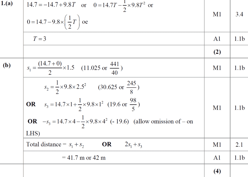

solution is here;
I just need to understand this part ##14.7 = -14.7 =9.8T##... why initial velocity upwards is a negative value? or i am interpreting it wrongly.

chwala said:
I just need to understand this part 14.7=−14.7=9.8T... why initial velocity upwards is a negative value?
It's ##14.7=-14.7+9.8T##.
Assuming these are values substituted into ##v=v_o+at## we have ##v=+14.7##, ##v_o=-14.7##, and ##a=+9.8##. Evidently the author has chosen the downward direction to be positive, thus the initial upward velocity is negative.
Likes MatinSAR and chwala
… and physics does not care which direction you consider positive. The author chose down as the positive direction, you chose up. Both conventions give the same result as long as you are consistent.
