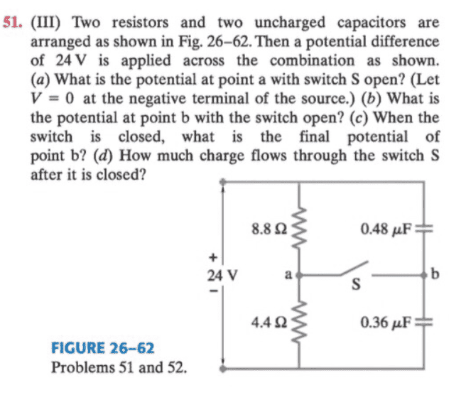

shown below
Ohm's law, Kirchhoff law,
I tried solving the part (a), and got I =1.82 A for the current value using Kirchoff's law.
Next, I want to use Ohm's law to calculate the voltage at point a.
Va = IR
In this equation, will resistance R correspond to 4.4Ω or 8.8Ω?
How do you determine which resistance to use when solving this problem?

Have you come across the idea of a potential divider? The voltage across either resistors is in proportion to the value of the resistance. The same idea carries across for the capacitors, except the weights are the reciprocals ##1/C##. Can you show why this is true?

You can use either resistor value.
You can use either capacitor value.
The problem states to use a potential value of 0 V at the negative terminal of the source.
What is the potential value at the positive terminal?
