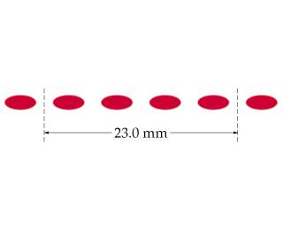

Light from a He-Ne laser (\lambda = 632.8nm) strikes a pair of slits at normal incidence, forming a double-slit interference pattern on a screen located 1.50 from the slits. The figure shows the interference pattern observed on the screen
What is the slit separation?
d*sin(\theta) = m*sin(\lambda)
y = L*sin(\theta)
I know i can solve this problem if i just find sin(\theta) but this is where I'm getting stuck.
Also, does the diagram tell me anything important? i thought maybe by dividing the 23mm by 4, i could get y (the distance between each bright fringe) but that proved to be fruitless when i tried solving for sinθ using 0.023/4 = 1.5sinθ but that didn't give me the correct answer for d.
nevermind. i figured this out.
The formula should be d*sin(θ) = m*λ.
Draw your diagram with one line horizontal from the slits to a bright central maximum and another line at angle θ to the next bright spot, separated from the first by x. You can figure out x from the given diagram and then you can get the hypotenuse in the new diagram using the Pythagorean theorem. Use the formula to solve for the slit separation distance d.
