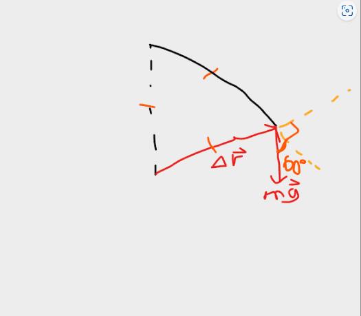

For this problem,
The answer is ##-4.70 kJ##. I am not sure what I am doing wrong.
My working is
## W = mgr\cos\theta ##
## W = mgr\cos150 ## (since angle between ##\vec g## and ##\vec r## is 150 degrees)
## W = -mgr\frac {\sqrt{3}}{2} ##
## W = (-80)(9.81)(12\sin60)(\frac {\sqrt{3}}{2}) ##
## W = -7063.2 J ##
Would some please be to offer some guidance?
Many thanks!

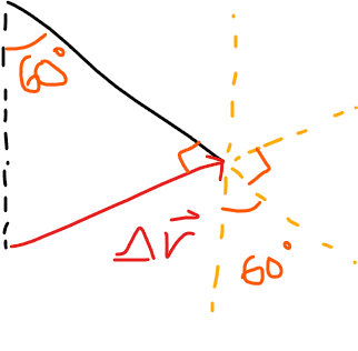

Please, attached diagram.
  • Spiderman.pdf
Likes member 731016

I suggest you redo the problem with 1 degree rather than 60 degrees and you should see your mistake.
Likes MatinSAR and member 731016

Callumnc1 said:
Thank you @haruspex! Spider man moves?
Thank you !
Wait, I'm sorry - I have objected to the wrong line.
It's this one:
Not according to your diagram.
Likes member 731016 and MatinSAR

Thank you for your replies @haruspex and @Lnewqban!
Sorry I don't understand how the angle between the line extending from the displacement vector and the force of gravity is not 150 degrees.
I think I must have got the angles wrong or something in the diagram. Could someone please show me how to correctly calculate the angle between the displacement and weight vector?
F is the force of gravity acting on spider man and W is the work done by the force of gravity on the spider man.
Many thanks!

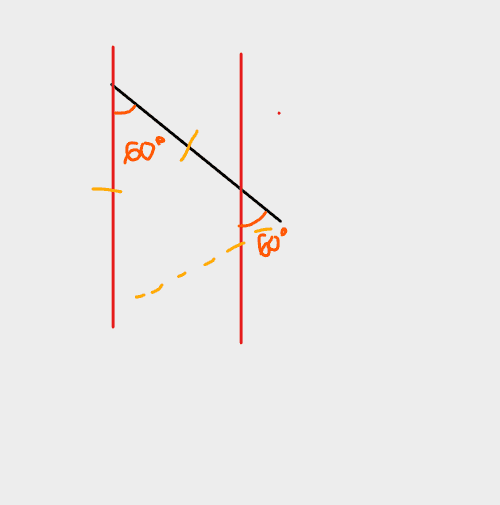

You have a triangle with two equal sides (length of the wire in the two positions) and 60 degree angle at the top. What are the other two angles?
Likes member 731016
Thank you for your reply @nasu!
I did not see that it was an isosceles triangle! The two other angles will be 60 degrees each.
I will redo my diagram now.
Many thanks!
Actually is equilateral, isn't it?
Likes member 731016

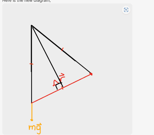

Here is the new diagram with the equilateral triangle:
It still seems to give ##\theta = 150## thought. I'm still not sure, how to find the correct ##\theta##.
Many thanks!
Many thanks!
What makes you think the angle between the mg line and the dashed orange line that goes up to the right is 90°?
Likes member 731016
There are no 90 degrees angles, as you mistakenly show in your first diagram. How can you get 150?
Likes member 731016

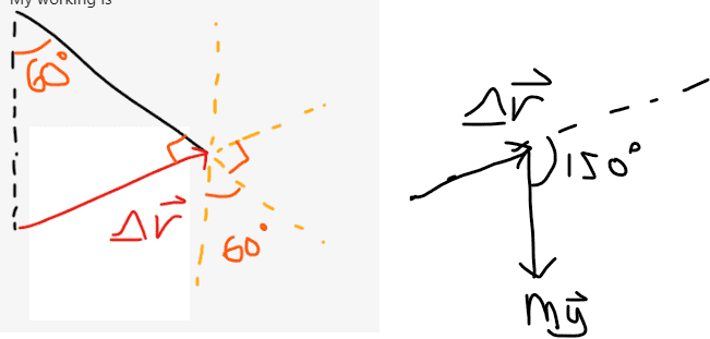

Thank your for your reply @haruspex !
Sorry, I did not mean the angle between the mg line at the dashed orange line at 90 degrees. It should be,
Many thanks!
Sorry, what do you mean there are no 90-degree angles?
I got 150 degrees since there is a right angle between the two dotted orange lines and a 60 degree angle between and the red mg line and dotted orange line.
Many thanks!
Many thanks!
Ok, but how do you get 60° between mg and the lower dashed orange line?
It would help if you were to draw it a bit more accurately.
Likes member 731016
Many thanks!
No, there is not. What is that dotted orange line? If you draw it perpendicular ot the direction of ##\Delta \vec{r} ## then the other angle is not 60 degrees. But you don't need that dotted line. Just draw the weight where ##\Delta \vec{r} ## starts.
Likes member 731016
Thank you for your reply @haruspex!

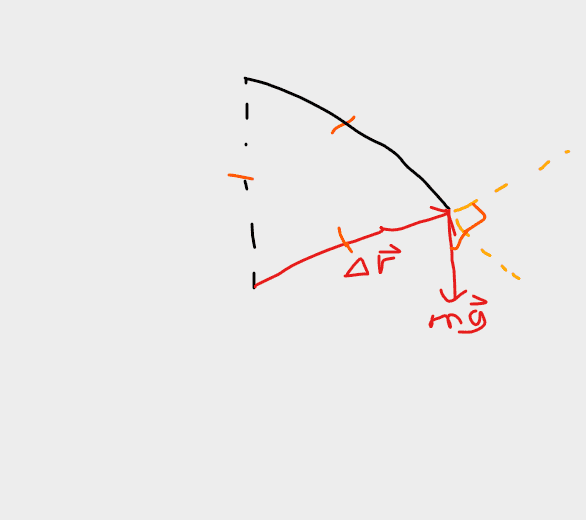

I think I got 60 degrees from the corresponding angles theorem.
Many thanks!
Thank you for your reply @nasu! I will do that.
Many thanks!
Many thanks!
That angle is 60 degrees but the extension of the black line is not along the dotted line that you show in the previous drawing. You see here that the black line is not at 90 degrees relative to this dotted orange line.
Likes member 731016
You keep bending lines.
Go back to your diagram in post #1, draw it accurately, and don't mark in right angles that you cannot prove are right angled.
Likes member 731016

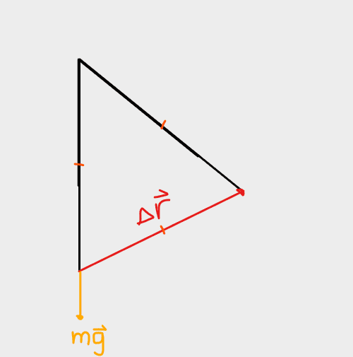

Thank you for your replies @nasu and @haruspex !
Here is the new diagram,
How is it?
Many thanks!

More accurate in some ways, but you have not marked in any angles, and you have moved the mg line over to the left.
Likes member 731016
  • #31
Thank you for your reply @haruspex ! I moved the mg line to the left so I could see from exterior angle theorem that ##\theta = 120~degrees##.
What way were you going to find the angle?
I think I also found ##\vec {\Delta r}## vector correctly now.
To find it I split my equilateral triangle into half to form a right angle triangle
I then found the opposite to be 6m so the total displacement must be 12m. But I guess I did not need to do that since the triangle has equal sides.
Many thanks!

Ok, so what is the angle between the force mg and the displacement ##\vec r##?
