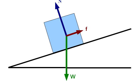

A normal force is a force that is exerted on an object by a surface in a direction that is perpendicular (normal) to the surface.
When you stand on the floor, the floor exerts an upward force on you to support you. In this case the surface of the floor is horizontal while the normal force exerted on you by the floor is vertical (i.e., perpendicular to the floor).
As another example, look at the attached figure which shows a block on an inclined surface. Note how the normal force on the block from the surface is perpendicular to the surface.
In your problem you have a block against a vertical surface (the wall). In what direction does the wall exert a force on the block: upward, downward, to the right, to the left, or none of these?
to the right?
No. The block pushes on the wall to the right. What does Newton's third law tell you about the force that the wall exerts on the block?
oh okay, I get it. The wall pushes on the block to the left whilst the block pushes on the wall to the right. The third law states they would be exerting the same force in opposite directions.
Yes, that's right. The normal force on the block from the wall will be horizontal and toward the left.
