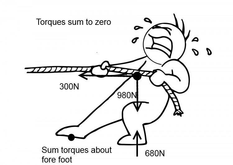

The diagram is incorrect as long as any of the blue forces are on it.

No, weight acts at the center of gravity, by definition. What is distributed is the normal force. There, should only be one green force and it acts vertically downwards from the center of gravity. It has no horizontal component, and it is not distributed down each leg.

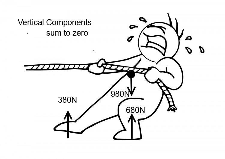

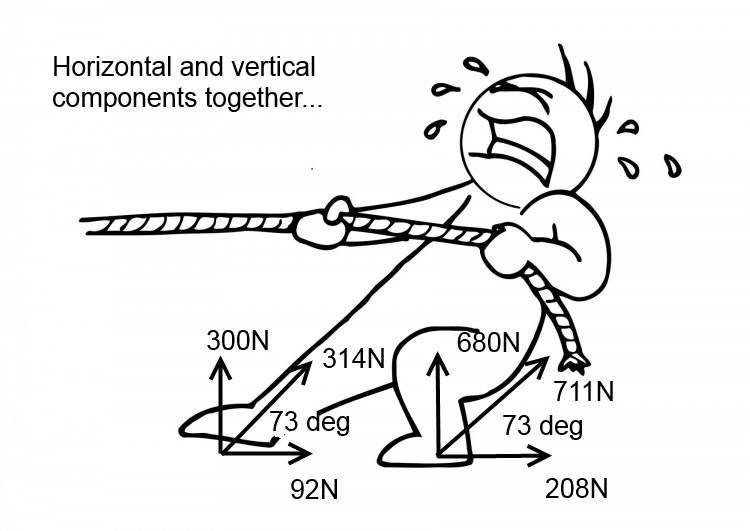

Personally I wish you hadn't complicated the situation by separating front and rear feet!
I don't believe you can calculate the total force on the front foot unless you calculate how the 300N friction force is shared between each foot. So I attempt that...
We have established that if the man was to lift his rear foot off the ground it appears he would apply 980N of force to the rope. If he only wants to pull with a force of 300N then some of the excess torque generated by his mass must be supported by his rear foot (which is under his COM)
If I make reasonable assumptions about the geometry of the drawing then the vertical component of the force on the rear foot must be 980-300=680N.
Then if the vertical components must add to 980N the vertical component of the force on the front foot must be 980-680=300N
Now look at the horizontal components...
The horizontal forces due to friction must sum to 300N but how much is carried by each foot? If we assume that the friction force is shared in proportion to the load on each foot then the friction force on each foot is
Front..
300* 300/980 = 92N
Rear..
300* 680/980 = 208N
So now we have horizontal and vertical components for the force on each foot...
Front...
Vertical = 300N
Horizontal = 92N
Rear..
Vertical = 680N
Horizontal = 208N
You can apply Pythagoras to work out the total force on each foot and some trig to work out the angle.
I'll just do the front foot...
Total^2 = 300^2 + 92^2
Total = 313N
Your diagram appears to show 424N but you don't explain how you get that figure.

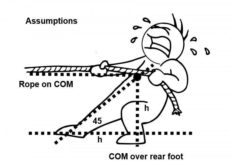

Ok this is my final word on this problem. Got to fix a leaking WC! I have produced the following diagrams.
1) The first shows some assumptions about the geometry such as him leaning at 45 degrees and his COM being over his rear foot etc. I also assume he is not accelerating (vertically, horizontally or in rotation).
2) The second shows the how the torques must sum to zero. The distances from the pivot are all the same due to the geometry. Let's call that distance h (see assumptions drawing). If we take anti clockwise as +ve then..
-980*h + 300*h + 680*h = 0 √
3) The third diagram shows the consequences for the vertical components. Let's take vertical as positive then
-980 + 300 + 680 = 0 √
4) The fourth diagram shows the horizontal components. I have made the reasonable assumption that the 300N friction force is shared in proportion to the vertical load on each foot. That calculation is done on the diagram. Let's assume right is positive then..
92 + 208 + (-300) = 0 √
5) The final diagram combines the horizontal and vertical components at each foot to give the total force at each foot (using Pythagoras and basic trig.). Note that the total force acting on each foot acts at about 73 degrees to the horizontal. There is no reason why this should be 45 degrees.
That's all folks.

PS: Some may question my assumption about the way the friction force is shared between the two feet but I think it's perfectly reasonable for a flat uniform smooth floor like a Gym. You also have to remember that in this problem the man is NOT trying to pull as hard as he can (980N at 45 degrees). He is only applying 300N. Most of his weight is carried by his rear foot.
  • #109
I like that assumption also, I think I would have made the same one. It is interesting that one consequence of that assumption is that the forces from the ground are parallel to each other.
The other assumption I might consider would be that the forces are whatever is required to minimize the torque about the hips. But that seems excessively complicated.

... Note that the total force acting on each foot acts at about 73 degrees to the horizontal. There is no reason why this should be 45 degrees. .

You may be right, but your basic assumption that LF is bang under the COM and consequently g is transmitted entirely on the back foot.
This situation is unrealistic because if you are pulling (and being pulled, let's not forget that the truck is in itself a simplification of the original problem:tug-og-war') CM is continuously moving , adjusting itself to the torque (sometimes instinctively or authomatically).
If one foot is under CM you can transmit all your weight on your left leg if no other force is acting on you, you can lift your right foot from the ground and then adjust your posture so that CM is aligned with the center of the left foot. (Position B)

I don't know where you got these numbers. The force at the ground is 808 N at 68°. The x component is indeed 808 cos(68) = 300 N and the y component is 808 sin(68) = 750 N. I don't know where 424 or 124 come from.
I showed you how to get the correct answer from Newton's 2nd law. Did you understand that? If not, please ask specific questions.

The man cannot lean at 45 degrees and only produce a force of 300N.
Dale assumed that you had made a mistake on the diagram and in his post #127 he calculated the angle had to be 68 degrees.
Q: Do you agree with his calculation?
If not then why not?
It's not acceptable to keep changing the problem when you don't agree with the solution given for the previous version.

I refer you to the basic procedure I outlined in post #107
I know you didn't like the assumptions I made (rear leg under COM) but the basic procedure is the same. Just modify it to suit your new version of the problem.
