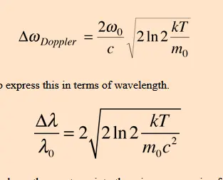

I don't understand how to go from one equation to the other
provided in picture
I want to understand how the two equations in the picture are the same. I am confused because \nu=c/\lambda. This would mean that the term on the right side of the equation in the square root, call it x, would then become x^-1. The resulting equation being \Delta\lambda = \lambda x^-1. But somehow this is not the case?
What you are saying is only true for the relationship between frequency and wavelength themselves - not their small variation.
From ##\omega \propto 1/\lambda## follows that ##\Delta\omega \propto \Delta\lambda /\lambda^2 \propto \Delta\lambda (\omega/\lambda)##.

A somewhat cleaner derivation:
The product ##\omega\lambda## is constant so ##0=\Delta(\omega\lambda) \simeq \omega \Delta\lambda + \lambda\Delta\omega##. This directly leads to ##\Delta\lambda/\lambda \simeq - \Delta\omega/\omega##.
