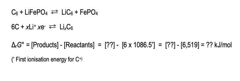

In writing up a paper on some research work on the effects of transients on Lithium Iron Phosphate batteries, I am laying out the thermodynamics and energetics for the reaction laid out below, but am having trouble finding the numbers for the reaction.
Does anyone know the correct figures to insert so I can get an overall Gibbs value for the reaction?
Thank you

When you write Li1 you mean monoatomic and non-ionic Lithium and with Li non-attached Lithium + ions?
No, he means Li1+xFePO4. (At least I think so; the equation doesn't balance however you interpret it.) He has not formatted it properly, and for this and other inaccuracies and curiosities of expression, I think this is a chatbot answer. The reaction he writes is wrong. LiFePO4 is the discharged form of the cathode, and Li is removed on charging:
LiFePO4 + 6C → Li1-xFePO4 + LixC6
Discharge is the reverse reaction.
There are lots of complicating factors in the energetics. Just on a quick search I found this: https://pubs.rsc.org/en/content/articlelanding/2019/nj/c9nj03041g
I can't access the full article, and you may already be aware of it.

As I understand it, the overall reaction is:
LiFePO4 + 6xC ⇄ Li(1-x)FePO4 + Li(x)C6
(I haven’t used the proper subscript formatting here)
but the proportion ‘x’ makes the calculations difficult.
Just looking at charging, the only relevant activity is:
6C + xLi+ + xe- to LixC6 (intercalated, lithiated Carbon) since the Iron Phosphate is common to both sides so can be ignored.
I’m inclined then to use published figures for specific energy density (90-160 Wh/kg) and work backwards to other values. Something of a cop out but, given the various unknowns, a reasonable approach 😗
For your calculations, I would estimate the theoretical capacity by using the approximation x = 1, though I don't think it ever goes fully to 1.
From what I remember, the theoretical potential for this reaction (from ΔG° =-nFE°) is considerably higher than the actual potential you measure for a cell (ca. 4V vs. ca. 2V, IIRC). For various reasons you don't convert all the free energy to electrical energy, so working back from the measured energy density may not give you what you're looking for.

Why do you add the masses on both sides of the equation? Reactants are converted to products without change of mass.
The "active material" here is LiFePO4. You can't treat "FePO4" as a spectator. The oxidation state of Fe is changing. The C will be present in excess, so the key parameter is energy per kg LiFePO4. But what are the "actual" figures you are quoting? Are they energy per kg active material, or per kg total battery weight?

So to be clear, the three figures for charge capacity are: theoretical specific charge capacity (Ah/kg from the molar masses), theoretical charge capacity for a specific battery (Ah and based on the masses of its active ingredients), and lastly the working charge capacity derived from actual discharge measurements on the specific battery. The latter are indeed a low percentage of the first value.
There is a corresponding set of values for the energy density and capacity in Wh/kg and Wh. I assume that the energy densities often quoted for new battery developments are theoretical values and not the much lower operational ones.
I note that the first values, using the molar masses method, are about 3% higher than some official values I have found using the Gibbs/reaction energies. Not sure why that is but it might be accounted for by the uncertainties in the tabulated values of formation energies. I think that molar masses are more consistently recorded and historically confirmed.
