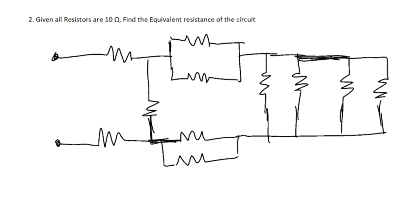

Find the equivalent resistance
i keep getting 45.3 ohms but the answer is 25.6 ohms
Can't tell where your mistake is unless you post your intermediate steps that lead you to a (false) answer of 45.3 ohms, but I did it my self and I found it to be 25.6 ohms indeed (25.555 to be more precise).
Yes I figured it out I wasn't using my common sense, thank you
Not exactly common sense, but it is kind of easy problem if you carefully identify the components in series and the components in parallel.
