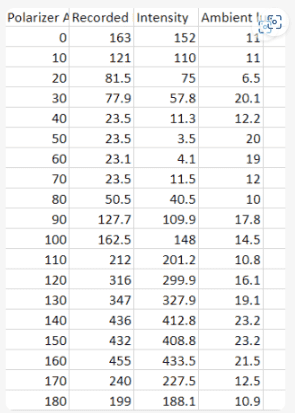

Suppose you have a magnetic optical rail with a laser at one end and a lux meter at the other end. You place a polarizer in between. Find a graph of transmitted power ##P_{trans}## vs polarizer angle ##\theta##.

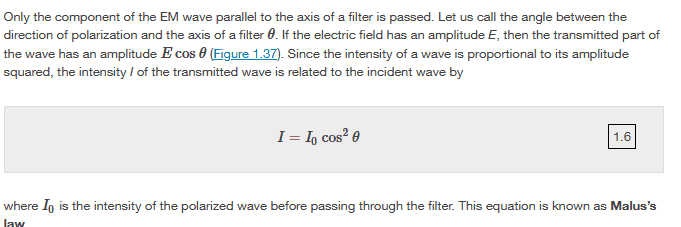

Given that efficiency of the polarizer is given by ##η = \frac{P_{trans}}{P_{max}} =\frac{I_{trans}}{I_{max}}## for when ##\theta = 0##, assume that ##η < 1##
Malus's law
##I_{trans} = I_{max}(\cos\theta)^2##
##\frac{P_{trans}}{A} = \frac{P_{max}}{A}(\cos\theta)^2## Since ##I = \frac{P}{A}##
##P_{trans} = P_{max}(\cos\theta)^2## (area can be cancelled since we are deriving this equation for one polarizer which we assume to have equal area on each side)
The data collected from the experiment is,
The first column is the polarizer angle measured in degrees.
The second column is recorded intensity measured in lux.
The third column is the transmitted intensity measured in lux. This is equal to the recorded lux - ambient lux
The fourth column is the ambient lux.
I also measured η = 0.543103 (dimensionless)
My confusion is how to find the transmitted power of the laser since the lux meter only reads the transmitted intensity.
So from the definition of power, should we multiply the transmitted intensity by the area of the polarizer? Or should we leave the transmitted power in terms of area A of the polarizer?
Many thanks!

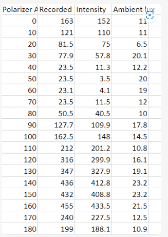

Sorry I have updated the post #1 to show my data collected.
Many thanks!

I don’t understand those numbers. How can you have a negative intensity? And how come the min and max are 180° apart instead of 90°?
Likes member 731016
Thank you for your reply @haruspex!
Yeah I think we made a few mistakes in collecting that data for the second time. The intensity should not be negative. The light coming out of the laser is polarized however, we are were not too sure what the direction of linear polarization was.
I will find some other better data too analyze.
Many thanks!

Here is the new data @haruspex,
Many thanks!

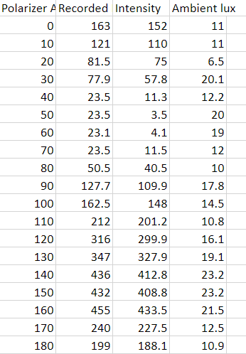

That looks reasonable. But as you wrote, you can only graph intensity from that, unless you know the source power. Did you also collect the intensity without the filter?
Likes member 731016
The power of the laser is 1 mW I think. Yes we did collect the intensity without the filter. The value read by the lux meter was 1136.7 lux.
Many thanks!

The shape of the curve is the same whether intensity or power. The difference is what the y axis means in terms of dimensionality and units.
You could mark the y axis in terms of percentage of ##P_{max}##. You know ##I_{max}## (intensity with no filter). The measured intensity as a percentage of that is the same as the power as a percentage of ##P_{max}##.
If you know ##P_{max}=1mW## then you can go one better and mark the y axis in mWs.

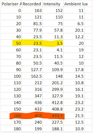

The max value for the transmitted intensity is when the polarizer axis is 160 degrees (seen graphically or from the table). So I think the plane of polarization of the laser is aligned with the polarizer axis at 160 degrees. Therefore, the laser angle must be 160 degrees. However, I am interesting how find it is using Malus' law.
Many thanks!
Callumnc1 said:
The values I am using to find the laser angle are ##I_{trans} = 152~lux## when ##\theta_p = 0## and ##I_{max} = 1160~lux##
Surely you want the minimum and maximum intensities (after subtracting ambient), which occur around 40°-50° and 130°-140° 50-60° and 140-150° in your table. Reassuringly, those are 90° apart.
Ideally, you should do a least squares fit to pin this down more accurately, but it looks to me that the true minimum would be around 52-54° and max at 142-144°.
Having determined that, it gives you an adjustment angle to move the minimum to 90° and the max to 0° (modulo 180°).

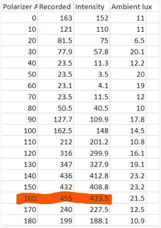

I thought Malus' law would work for any value from the table substituted into the equation.
Why is the max intensity at 130°-140° (or 142-144°) not 160°? I understand what you mean when you say that max and min laser angles should be separated by 90°. I find that the min intensity to be at 50° however, and this is 110° from the max intensity (which I found from the table to be at 160°).

The 160° reading looks like an outlier. If you graph the data you have this should be evident. But I'll try to figure out a way to do a proper regression fit.
Likes member 731016
haruspex said:
Sorry, I made a few mistakes there. Please see the edited version.
Please don't worry about your mistakes! I have graphed it on excel. I see what you mean that 160 degrees is a outlier. Maybe I should try an extrapolate to find the max?

I am not sure whether the slanted bit is correct. In ##{P_{trans}} = {P_{max}}(\cos\theta)^2## , ##P_{trans}## is the power with the filter at angle ##\theta## and ##P_{max}## is the power with the filter at 0°. According to the textbook screen shot below, ##I_{max}## (or ##P_{max}##) is the power of the polarized beam before going though polarizer (i.e it the power without the filter).
Do you please know weather that is correct?
Where ##I_0 = I_{max} = P_{max}##
The screen shot was taken from https://openstax.org/books/university-physics-volume-3/pages/1-7-polarization
Many thanks!

The data collected is below if you are interested.
Many thanks!
Polarizer axis angleRecorded Intensity (Lux)Intensity (Lux)Ambient Intensity (Lux)
0​
163​
152​
11​
10​
121​
110​
11​
20​
81.5​
75​
6.5​
30​
77.9​
57.8​
20.1​
40​
23.5​
11.3​
12.2​
50​
23.5​
3.5​
20​
60​
23.1​
4.1​
19​
70​
23.5​
11.5​
12​
80​
50.5​
40.5​
10​
90​
127.7​
109.9​
17.8​
100​
162.5​
148​
14.5​
110​
212​
201.2​
10.8​
120​
316​
299.9​
16.1​
130​
347​
327.9​
19.1​
140​
436​
412.8​
23.2​
150​
432​
408.8​
23.2​
160​
455​
433.5​
21.5​
170​
240​
227.5​
12.5​
180​
199​
188.1​
10.9​

Thank you very much for pointing that out @haruspex!
It appears there must be an error in that textbook I was using. I checked HRK vol 2 and found
Which agrees with what you said.
Many thanks!
  • #31
Oh wait, I think the OpenStax textbook just assumed an efficiency equal to 1.
Many thanks!

I plotted your data. Normally, one assumes the x values are reliable, so curve fitting minimises the sum of squares of the errors in y, but your data looks very odd. The trough on the left is about 112° wide, then the crest is only 68° wide. It's as though there is some systematic error in the angle readings.
Alternatively, the high crest on the right is what's wrong. If we throw away the data from 120° to 170° then the curve looks respectable. Sketching in the gap created, the peak would only be about 130.
I assume you only did one run-through of the settings, which is a shame.
Anyway, I was able to verify my formulae.
