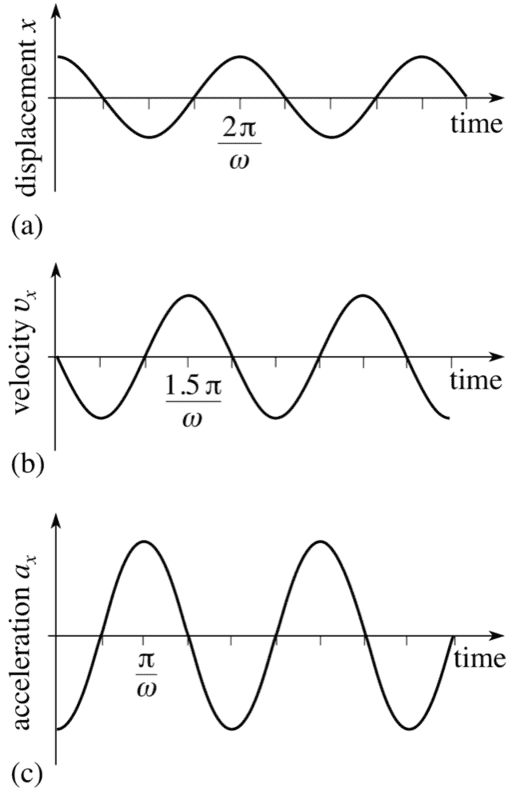

Hello, I am really struggling to sketch the following graphs to show how a mass with a piece of paper attached to it varies with time, over a time period of 2T, for: 1. Energy 2. Displacement 3. Velocity 4. Acceleration
x=Acosωt v=-ωAsinωt a=-ω^2Acosωt
I understand that velocity is defined as the rate of change of position or the rate of displacement; and that acceleration is defined as the rate of change of velocity (it is the derivative of velocity).
Morever, I believe I know that for SHM these graphs vary sinusoidally (I have attached a picture of how I think these should appear).
However, for a mass with a piece of paper attached could these graphs be represented by a harmonic oscillator with a small amount of damping? I really do not know where to begin in drawing these, I am very confused.
It's not clear what is the significance of the piece of paper! Is this a translation?
I have no idea, I really am very confused. The question just states " Sketch the following graphs to show how a mass with a piece of paper attached to it varies with time, over a time period of 2T"
So, the net force is no longer a constant...
you need to model the new net force... a constant plus a new contribution.
If it were damped, what would a sketch of the position-vs-time graph look like?
From that get the other two
[velocity-vs-time is a graph of the slopes of the position-vs-time graph,
acceleration-vs-time is a graph of the slopes of the velocity-vs-time graph

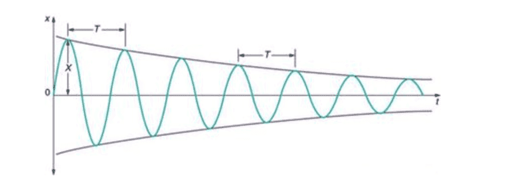

Thank you for your reply. I have attached what I think the displacement tie graph for a draped oscillator would look like. However, I am uncertain how to find the v-t and a-t graphs from this? Would this be correct anyhow for the s-t graph?

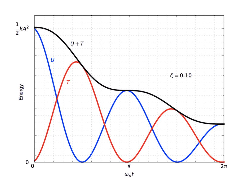

And would the energy-time graph for a damped oscillator be as shown in the attachment ?
