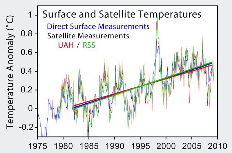

You can see it in the graph, but think about it logically: if the average surface and air just above the surface temperatures were didfferent, heat would flow from one to the other because they are touching each other.

But again, as you can see from the graph, the plots lie pretty much right on top of each other, so I don't see a hair here to split.
My question really is whether or not sampling air temperature is the same as directly sampling surface temperature.
The same how? It is done by a different method, but returns nearly the same results.
I would be interested to see if there is any example of data plotted for actual surface temps vs air temps.
Is there something wrong with the graph I posted?

I am also not convinced by your suggestion that satellite measurements in your graph are taken directly from the surface. Satellites may be able to do that, but I don't think UAH and RSS represent that. Wikipedia says:

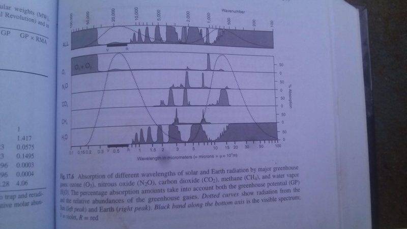

Although symmetric molecules like O2 & N2, don't change their "dipole moment" when they vibrate or rotate molecules like CO2 can. CO2 is actually linear molecule: 0---C---0 with the Os having "stolen" some negative charge, on average, from the C. Its dipole moment is zero when in it ground vibrational state but not when excited in the "a-symmetric" vibrational mode.
I.e. with this configuration O--C----0 and then half a cycle later is O----C--O. When this vibrational state return to the ground state, its loss of energy is given to the IR photon emitted. I'll call the wave length of that photon "L."
When a photon of wave length L is emitted by the Earth's surface and there are no clouds in the way, it still has only about 1/3 probability of escape to space now that the concentration of CO2 is about 400ppm. And to even get that ~33% chance, the photon that does leave Earth is not the same as the one that left the surface originally. That original wave length L photon, was absorbed and its energy re-radiated by some other CO2 molecules at a different altitude. I.e.. the escape to space of wave length L photons is a random walk process. Most that do escape, have come from a high altitude, where the temperature is much lower than that of the Earth's surface below them.
They come crudely speaking, from the top "optical depth" of the atmosphere, which is a smaller layer than for most photons not of wave length L. That high layer's colder temperature limits the intensity of this L wave length IR as no surface or volume can radiate more intensely than a black body at the same temperature can. Thus man is lucky that CO2 effect on Global Warming is limited. The CO2 concentration could increase five fold and the IR loss via wave length L radiation would not even double. We say the CO2 absorption bands are nearly "saturated."
Unfortunately that is not true of CH4, which is a 3-D molecule, with more and stronger absorption bands. During the first year after a Kg of CH4 is released it does 120 times more global warming than a Kg of CO2 does, but as its half line in the air is only 12.6 years* during the first decade after puff was released it does only about 84 times more global warming as same mas of CO2 does as CO2 half life is about 1000 years.
I'll stop here as getting too far from your question, but at least you should now understand it was a quite complex question.
