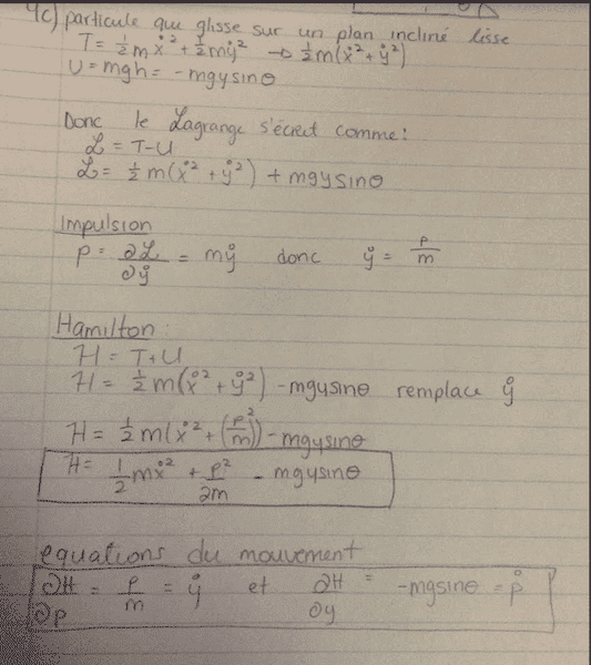

I am asked to find the Hamilton equations for a block on an inclined plane (no friction)
Please ignore the fact that my steps are written in French (sorry!)
I am no longer sure of what I'm doing when it comes to finding the momentum. I here chose y' and just ignored the x', because that seemed logical to me at the time. How can I correct my solution if it isn't right?
You should make clear the orientation of the x and y-axes.
Treat the ##\dot{x}## term similarly to how you treated the ##\dot{y}## term.

Will I have two different equations for momentum then? And then add them together for a total momentum?
You will have a differential equation for the x-component of momentum and a separate differential equation for the y-component of momentum.
Since you didn't state the orientation of your axes, I am having to guess the orientations based on your equations.

x measured horizontally across the slope, and y measured down the slope

I think I understand, I will have to use the definition:
Yes. But ##p_i## should not be "dotted" (time derivative) in ## H = \sum p_i \dot{q}_i - L ##.

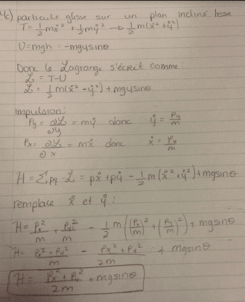

This is my final answer:
In your second equation for ##L##, there is a sign error in the kinetic energy part. But you corrected it later.
In your expressions for ##H## you've dropped ##y## from the potential energy part.
Otherwise, looks OK.

You showed at the end of your first post how to get the equations of motion by taking partial derivatives of H. But you have two components of p: px and py.
So will I derive 3 times, once for px, once for py, and then for theta?
No, just twice. Theta is not a variable. You could call theta a parameter. Theta is assumed to have a fixed value as the block slides on the incline.
