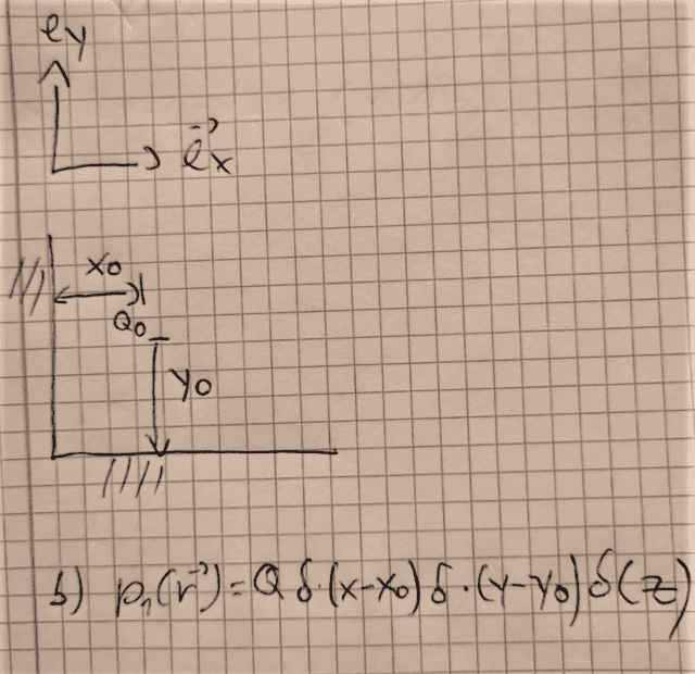

Guys I have Problems with this task The arrangement consists of a point charge Q at a distance (x0, y0,0) from the origin and two perfectly conductive surfaces in the (x, z) and (y, z) plane
a) Mathematical description of the space charge density p of the original and mirror charge using the delta function. Consider the perfectly conductive surfaces as infinitely extended in the respective direction and carry out reflections. b) Calculate the potential
c) Draw lines E field
Has somebody ideas for a)and b) because I am learning currently
Here the sketch to the task
https://ibb.co/zbSyb3d

Welcome to PF.
The picture of your sketch is pretty fuzzy, but it looks like it is a single point charge that is located a distance awat from two orthogonal conducting planes? If you have a better picture or can post an image of the actual problem statement, that would help.
Also, you need to show your work before we can offer tutorial help.
And what do you know about the E-field lines for a point charge above a single conducting plane? What does it mean to use a "mirror charge" image, and how does that simplify the problem?
I made the sketch a little better .I haven't got a better on .
I did a little work in b) which is in the pic but don't know what to do further:-p:-p
https://ibb.co/0CqtSqY

I can't read the LHS of the equation, but the RHS looks right for the space charge density of the point charge.
Please post algebra as typed in, not in images (per forum rules). Use LaTeX if you can. There's a guide at the link at bottom left.
What about the mirror charges? Where are they, and what are their signs?
Hint: it's very like looking at your own reflections in two mirrors at right angles.

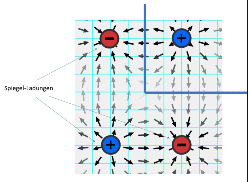

Buzzer33 said:
Do you know how to draw line E field ?
https://ibb.co/6DxjK2W
The diagram at that link looks good. Doesn't that do it for you?
