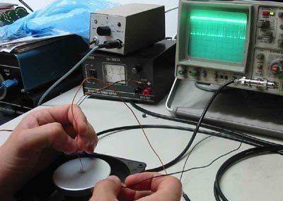

Experimental Results
O.k. everyone.
I located a small cylindrical conducting magnet and recreated the set up reported in the paper I read. I found one measuring .510 diameter x .592 length. I am not sure what material the magnet is, but it is either hard steel or alnico. It is not ceramic. It had a resistance of about 2 ohms when I placed the leads one on the axis of rotation and the other on the circumference, to check that it was a conductor.
I chucked it into my little bench lathe insulating it from the jaws with plastic and made contact with the circumference with an electrical brush taken out of an electric mixer motor. The brush was also insulated from the toolholder by shims of plastic, top and bottom. I made contact with the axis of rotation by chucking a pencil into the tailstock and touching it up against the magnet. I cut the wood away from the pencil down to the carbon about an inch back from the tip to have a place to touch the meter leads.I checked for continuity with an ohmmeter both before and during spinning of the magnet and there was always continuity.
There was, however, no voltage and no amperage during spinning.
I checked at several increasingly faster speeds, checking the continuity each time. There wasn't the slightest little jiggle of the needle when I set it on dc volts or dc amps.
As far as I'm concerned, a rotating conducting magnet does not generate any current in the absence of a stationary conductor.
I can't account for the results reported in the paper I read, but I no longer believe what was reported is accurate.

I tried the configuration you mentioned of two magnets on each side of a conducting disk all rotated together. I used two speaker magnets on opposite sides of an aluminum disk.
The magnets are 2.937 inches in diameter x .404 thick. The disk is 3.414 diameter x .025 thick.
I glued both magnets to the aluminum with superglue but wasn't able to get them perfectly concentric with each other. One was about .005 eccentric. This made the lathe vibrate a little when I spun them, and I never dared to crank it up to full speed. I got up to about 1500 RPMs and didn't dare go higher.
Anyway, with this configuration, I did, in fact, get the tiniest little voltage and current. The needle on the meter moved enough that I was sure it had actually moved and I was sure it was actually dropping back to zero when I removed the leads from the circuit. It looks to have generated one or two millivolts.
It rose half a hair higher when I doubled the speed.
I really think all that was happening is that I was inducing a miniscule current in the brush that was in contact with the circumference of the disk, and expending quite a lot of watts to do it.
Zooby

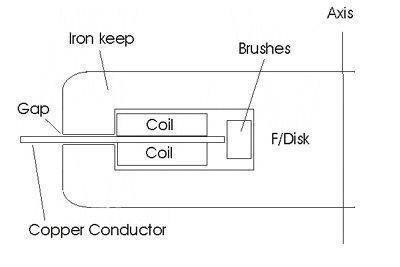

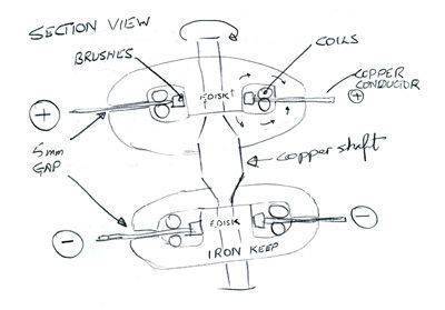

Maybe its time to explain a little about on of the experiments I was involved in. (There being some interest in the subject :smile:)
The machine set up was to clear up some initial doubts on the faraday generator/motor effect and was built to completely enclose the magnetic field to eliminate any claims of induction in the external circuit. the field was created by copper coils calculated and tested to give 1.6-1.8 Tesla (16000-18000 Gauss) which was the saturation of the iron we were using. The core was made of two F/disks of 8 inches diameter mounted on a hardened copper shaft with a copper slip ring silver soldered to its perimeter. The disk was part of or centre of the main magnetic keep that enclosed the coils leaving only a 5mm gap through which a copper plate passed in order to extract the current and also a base to hold the coils and brushes. You can imagine the shape as something like two dinner plates cupped together. there were two units on the same shaft in order to double the voltage generated. The brushes were made of 95% silver/carbon (No expense spared) so the no load consumption of the DC motor was only 200 watts approx. Even after all this the machine only produced the calculated 5.6 Volts at 3000 rpm and 3000 Amps approx.
An almost identically sized faraday disk Motor would turn proportional to the intensity of the magnetic field etc.
One of the fascinating features of this set-up was to see the motor side turn at any speed (from almost standstill to the equivalent speed of the generator) adjusted by the field strength, with a torque equivalent to the Watts involved. That is even at 1 rpm the turning power was there you could hold on to the shaft and it was humanly impossible to stop by hand.
If you capture the set-up from my basic explanation you may appreciate that the generated current could have been produced in the core/centre or in the gap through which the copper plate passed in order to extract the current, which of course does not prove or disprove movement of the field.
After all this experiment gave me a very clear view of the concept and did not give any inclination towards OU.
The use of coils maybe give an easier comprehension of the field being independant to the source but does not prove rotation or non rotation of the field.
I have questions about this that I'll ask later because they are less important to me than others I have.
Very strong magnets.
This I don't understand. The disks were copper. How could they form part of a magnetic circuit? You cannot put a piece of copper across the pole of a horseshoe magnet and form a magnetic circuit. A "keeper" must be of a material in which a magnetic field can be induced by proximity to another magnetic field.
I'm also not understanding the 5mm gap. Perhaps because I'm not sure of the orientation of the electromagnets with regard to the disks. You spoke earlier of a "uniform magnetic field". What that says to me is that on one side of the copper disks you have a north pole pointed at the disks which completely covers the whole area of that side of the disk. On the other side you have a south pole that completely covers the whole area of that side of the disk. There is attraction between the magnets and the magnetic lines of force go directly through the copper disks. Is this how you had it set up?
And there was nothing in the space between the "dinner plates, correct?
Here, now, is something I find very problematic. 5.6 volts times 3000 amps makes 16,800 watts. You say you're putting roughly 200 watts into the driving motor, and so the rest must be going into the electromagnets. The trouble is that since it is a static magnetic field there is no reason you couldn't replace the electromagnets with permanent magnets of the same strength and apparently harvest the same 16,800 watts with only a 200 watt imput.
I understand this wasn't the focus of your experiment, but you can see that you are proposing something that inadvertantly becomes a case for "Free Energy".
What do you mean "the motor side"? Thus far, all you have mentioned is a generator.
In view of these other claims about rotating the conductor and magnet together and still generating current, what I need you to make clear is whether or not your electromagnets were fixed to the disks and rotating with them, or whether the conducting disks, alone, rotated.
I'm not exactly sure what the concept of OU means or implies, but if the claim is that you're getting more energy out than you had to put in, then your set up seems to have that capability were you to replace the electromagnets with permanent magnets of the same strength. That ought not to be possible, and I don't suppose it is. I hope you can understand the problem I am percieving with getting 16,800 watts out of a device that is essentially only drawing about 200 watts to operate.
Which brings us back to your other claim about gluing two magnets to a conductor and rotating the whole sandwich together and being able to take current off of it. I think I will try rotating the magnets, one on each side of the conductor, opposite poles, and holding the conductor still. If I get an appreciable amount of current from the conductor it should demonstrate that the magnetic field rotates with the magnets. Does that sound right?

The whole rotor was soft iron including what is conceptually the "faraday disk" then in order to get a good contact to the circumference of the disk a copper slip ring was silver soldered to it and then the shaft between the two assemblies was also hardened copper in order to offer the lowest possible resistance to the current.
Take the analogy of an apple having been eaten in a way that the waist or thinner part is the generating disk and the upper and lower stubs which have a greater diameter are such as to almost touch each other creating a kind of cavity. Now imagine squashing this apple down to the shape I described of two dinner plates cupped together with its core still in tact, all soft iron. Through the gap passes the copper plate that doubles as a support for the coils and brushes inside the cavity and also is the conductor extracting the current. The total diameter of the rotors was approx 15-16 Inches

P.S. I am still curious about how the magnetic field was oriented in your machine. You haven't explained the orientation of the poles yet.

Zooby
Dont forget that in order to get two disks mounted on the same shaft each had to be completely contained in opositely oriented fields because they were rotating in the same direction. This is more complicated than it seems, I will try to send a diagram.
Binki

Here is a very quick sketch, it is not very neat but maybe you will get the drift from this sectional view. The two units are magnetically independant which is the only way to put them in series and double the voltage.
As to you other comment on the current drawn fron a thin conductor: The current is only limited by the load capacity of the conductor before losses i.e. copper has a limit before heating of 3000 Amps per square inch of conductor. If you were able to draw more current than the capabilities of the conductor you obviously reach a meltdown point.
Binki

Thanks for the sketch, Binki. Your machine is much more complex than I thought, and I still don't quite understand how it worked, but I'm more clear on the setup.
You say the voltage is tied to the flux density. In a normal generator voltage is tied both to the number of turns and the speed of rotation. What does faster rotation do in the homopolar dynamo? Increase the amps?

Zooby
Revise a little bit the calculation for generating a VOLTAGE: Speed, Field strength, Conductor Length.
Speed relates to only one conductor on the faraday disk as oposed to being multiplied by the number of turns in a conventional generator.
Field strength (Gauss) is the same for both systems - although optimizing is recomended in the farady disk for the above reason.
Conductor Length is the radius of the disk (within the field) whereas in the conventional generator this is multiplied by the turns.

Thanks, Binki, that makes sence.
My impression from your sketch is that the coils created a pole over the whole area of each side of the disks, all north on one side and all south on the other side of the disk. Is that how it was?

Yes, but don't forget that the faraday disk was also iron like the rest of the magnetic circuit, the only gap in the magnetic circuit was the famous 5mm gap all the rest was iron, so you get a perfectly even magnetic field.
Binki
  • #60
Oh. I didn't catch that about the disk being iron before. That certainly complicates what was going on.
Do you think that in a conventional Faraday generator, which has the magnetic field in just one spot, like Faraday had, would work with my notion of the sandwich of thin conductors to multiply the voltage?
