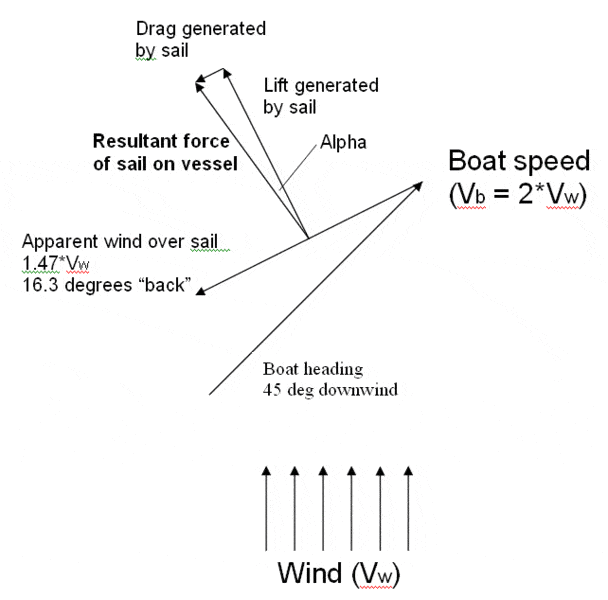

By the way, your diagram attachment still shows as a red x, so apparently it's not been uploaded by physics forums yet. You might want to use an alternate host in the meantime.
That's bizarre! I didn't realize what you meant initially about the red x. It's working fine in my browser. It's a .gif image. Is it possible that it's a problem with your browser? This is where it's supposed to be:
https://www.physicsforums.com/attachment.php?attachmentid=15991&stc=1&d=1224565850
Here you go:
http://www.putfile.com/pic/8419299

Also, I have constructed a vector diagram and analyzed it as I have asked spork to do several times. Its pretty clear just by looking at the diagram itself that the thing will never have a downwind component faster than the wind. If I have time today, which I probably wont, I'll graph the resulting equation you get from the graph to make the point a little more clear. I'll get it all posted by the end of the weekend at the latest.
I guess you haven't seen the diagram I posted on both this and the other forum. I guess you haven't seen my explanation detailing every aspect of the diagram.
Either your diagram is wrong, you're interpretting it wrong, or both.
Forget the "resulting equation" - show us your diagram.

By the way - you want analysis? I've posted a vector analysis showing exactly why this is possible and how it works. Given that I have an M.S in aero engineering I think that qualifies as "analysis". And I assure you it's absolutely correct.

  • #62
I just wanted to address the problem of whether a wind power craft (sailboat or ice-boat etc) could zig-zag downwin faster than the speed of the wind. This I believe might be possible.
Starting only with the assumption that a craft could travel into the relative headwind (apparent wind) at an acute angle phi I calculated the downwind component of the craft velocity and determined when it was a maximum.
Note that this analysis doesn't address the case where the craft is traveling directly downwind because it doesn't properly consider the fact the relative wind speed will appraoch zero.
See attached figure where,
W = wind velocity.
V = craft velocity.
A = relative (or apparent) wind velocity.Applying the sine rule to the velocity magnitudes gives,
[tex]\frac{V}{\sin( \phi + \theta)} = \frac{W}{\sin \phi}[/tex].
BTW. Recall that [itex]\sin( \phi + \theta) = \sin(\pi - \phi - \theta)[/itex]
Rearranging and simplifying gives,
[tex]\frac{V}{W} = \frac{\sin( \phi + \theta)}{\sin \phi} = \cos \theta + \cot \phi \,\, \sin \theta [/tex].
Define alpha as the ratio of downwind velocity component to wind-speed,
[tex]\alpha = \frac{V \cos \theta}{W} = \cos^2 \theta + \frac{1}{2} \, \cot \phi \, \sin(2 \theta)[/tex].
Differentiating wrt theta (and simplifying) gives,
[tex]\frac{d \alpha}{d \theta} = \cot \phi \, \cos(2 \theta) - \sin(2 \theta)[/tex]
Stationary point is at,
[tex]\tan(2 \theta) = \cot \phi [/tex],
[itex]\theta = \pi/4 - \phi/2[/itex]. (assuming phi is acute).
You can show that this corresponds to a maximum. Substituting this back into the expression for alpha gives (after some simplification),
[tex] \alpha_{\max} = \frac{1}{2} \, ( 1 + \cosec \phi )[/tex]
Since cosec(phi) is greater than one it follows that the maximum value of alpha is also greater than one.
