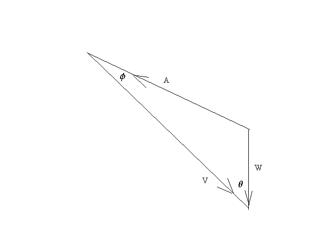

  • #84
red x
spork said:
It's a .gif image.
It's working now, as stated, it takes a while before an attached image is approved, so I normally post a link as well when I do attachments.
fan blowing on sail
This is the same principle as a thrust reverser on a jet engine.
Not quite, the jet engine uses a compressor and heat to create a huge pressure jump. You'd need a strong power source and a prop with a pressure jump to higher than ambient to pull this off. A high efficiency prop wouldn't work, because the pressure jump occurs below ambient, and air is decelerating once it passes through the prop disk.
LURCH said:
If it can go downwind faster than the wind, then it can sail when there is no wind.
The device is relying on the difference between wind speed and ground speed as a source of power, which is independent of the device speed. In the case of the treadmill, the treadmill is moving backwards while the air is still. In the case of the outdoor run, there's a tail wind and the ground isn't moving.
Although wind versus ground speed is independent of device speed, which allows for the concept of apparent wind to work, there is a limit to downwind speed (Vmg = Velocity made good). The sail has to divert the apparent wind so that it generates a force in the true direction of travel of the device.
For Vmg/Vt to be greater than 1, it would seem that this same diversion of apparent wind has to include an upwind component > (Vmg - Vt), otherwise there would be a net drag in the direction of the wind. I haven't seen this aspect of the issue explained.
Assuming the formula stated for a device with a Beta of 14 degrees, I made a graph of Vmg/Vt versus heading offset from true down wind. It peaks at about 2.56 at 38 degrees.
http://jeffareid.net/misc/dwvhdg.gif
Getting back to the original post, the issue is propeller efficiency, and the ability for the propeller situation to turn into a situation similar to the apparent wind situation of a ice or land sail boat. Even with no drag, there's an induced efficiency factor that limits the efficiency of propellers (I think this is related to the fact that a propeller operates in it's own induced wash). Propellers can have overall efficiency factors greater than 90%. I'm not sure what is required for the device shown.

I'll locate the video link. Are you convinced that an ice-boat can tack downwind such that its downwind velocity component is greater than the wind speed?
FWIW, Your vector diagram has convinced me you are right (I think):smile:. But also the vector diagram would also show an ice-boat can not go DDWFTTW, whereas the 'wind trolley' can?
With emphasis on the D
