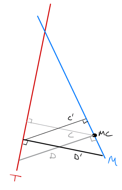

I did nothing of the sort. I switched M and T everywhere in the original statement, which is the only way you can claim symmetry. Please stop being disingenuous.
Here is the case of your actual setup in Minkowski space. Based on the inertial frame where both T and M have the same speed so you do not misconstrue either of them being assumed to be stationary.
C and C’ are both 4 ly and D and D’ are both 2.4 ly. Everything is symmetric. The ”weird” orthogonality is just how orthogonality works in Minkowski space.

No. As you can see from the diagram - and as I also told you previously - you change the relevant events when you change the statement. You should not be surprised that T is 4 ly away at some time and 2.4 ly away at a different time.
this is interesting. but the sequence of events doesn't seem correct. that is weird

This is completely unhelpful. You cannot just state that something seems ”weird” without specifying what it is. If you do that there is no way to correct you.
(Spoiler alert: Everything in that diagram is in accordamce with what has been specified. If something seems ”weird” to you, then that is where your understanding of special relativity is lacking.)

No, this is wrong and a misrepresentation of what the diagram shows.
T 2.4 ly away in M’s frame is the simultaneity D in the diagram. T 4 ly away in M’s frame is the simultaneity C’ in the diagram. C’ clearly lies below D.

This is simply wrong. This is not a proper spacetime diagram. The proper spacetime diagram was posted by me above. Please refer to that instead of making up your own faulty notions. Your diagram completely fails to account for the relativity of simultaneity. You will simply never understand relativity without a proper understanding of the relativity of simultaneity. Instead you will get lost in a quagmire of imagined paradoxes.
Note in the actual diagram how the blue and red lines do not coincide! They have different slopes. This is the relativity of simultaneity.
It is true that the event where C and D meet on M and the event where C’ and D’ meet on T have spacelike separation. This means that the order in which they will happen is going to depend on the reference frame - again relativity of simultaneity! In the frame I based the diagram on they both occur at the same time due to symmetry.
However, in T’s frame CD occurs before C’D’ but in M’s frame C’D’ occurs before CD. This must also be the case due to symmetry.

That is correct; the time ordering of spacelike separated events is frame dependent.
dwspacetime said:
the reason for something to happen could be the result.
No, it can't, because spacelike separated events in relativity can't be causally connected. Neither can cause the other or be an effect of the other.
