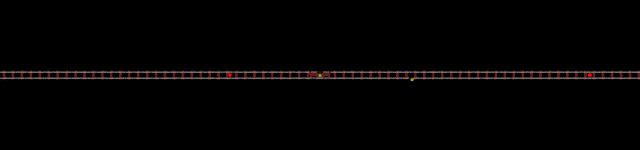

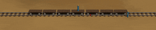

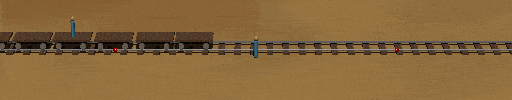

  • #118
name123 said:
I suspect this thread is about to be shut down, as considering this seems verboten.
The point is that if there were two differing opinions about what you experienced, and you only experience one of them (or neither), are the claims about what you didn't experience equally as true as any (if there were any) about what you actually did experience?
That never happens. Everyone will agree as to what happens to any given observer, though they might disagree as to the timing of some event that led to what that observer experienced.
For example, consider the following scenario.
You have an observer on the tracks and one in a railway car. Flashes of light are emitting by the the red dots and meet at the track observer just as the railway car observer passes him. Thus both flashes reach both observers at the same instant.
Here's those events according to rest frame for the tracks.
Here are the same events according to the railway car rest frame. ( please forgive the fact that I didn't include length contraction with this example)
In this frame, the light are emitted at different times, yet they still meet when the observers pass each other. Both frames agree as to each observer experiences while disagreeing on whether or not the flashes were initially emitted at the same time.
Or we could consider the traditional Train experiment.
The flashes are still emitted at the same moment and reach the the track observer at the same time, however now they are emitted at the moment that the train observer passes the track observer (according to the track observer frame.
Again first we look at the track frame:
Here the train observer runs into the right flash before before the left flash catches up to him. The right flash hits him when about a third of the way to the right red dot and the left flash catches up to him when he reaches the right red dot. The flashes reach the track observer when the rear of the train is about two car lengths away.
Now the same events according to the train.
A few things to note. In the last image, the train fit exactly between the red dots. But this was a "length contracted" train according to the Track frame. In the train frame, the train is its proper length and the tracks are length contracted. As a result, the train no longer fits between the red dots and the front of the train reaches the right dot before the rear of the train reaches the left dot.
The flashes are still emitted when the end of the train reaches a red dot. Thus the flashes are emitted at the different times. The right flash still hits the train obsever when he is ~1/3 of the way between track observer and right red dot and the left flash reaches him when he is next to the right red dot. the flashes still both reach the track observer at the same moment and when the rear of the train is about 2 car lengths away.
So while observers on the train and tracks disagree as to whether or not the ends of the trains reached the red dot at the same time or not and whether or not the flashes were emitted simultaneously or not, they are in perfect agreement as to what any observer on train or tracks directly experiences.
