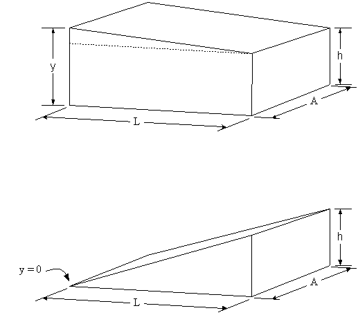

The shape is 3D trapezium with a base A and a length L. The front end is shorter than the back. The front is height h and the back height Y.
What is the resistance of a current moving from h to Y?
R=ρL/A

From your description of the geometry, if you let y go to zero won't you end up with a wedge rather than a rectangular solid? Perhaps the height of the 'back end' is meant to be y+h?
I tried to draw it but it ended up looking terrible.
So it is basically a right triangle sitting on top of a rectangle when you look at it from the side. Also it is 'A' deep from this perspective and both are 'L' long. The point of the triangle is (the short side) is height 'h' and the back side is height 'y.' So when 'y' goes to zero the triangle goes away. It is not quite y+h. Rather you could say it is h+(some other variable)=y.

I still don't see how if, the back end has height y, when y goes to zero the back end can be anything but zero height. That makes it the thin end of a wedge.
Shoot, you're right. The back end is y+h. I don't know why I made that mistake. So, you'd be right if it is as I said. You're drawing is correct although except for that. The current runs right to left as pictured there.
Sorry about that mistake.
My area has to be wrong. I was using that Y as my total back end length in my area equation.
Can I simply modify it as so or is it totally wrong now: z=\frac{x}{L} ((y+h)-h)+(y+h)?

If h is the height of the rectangular slab, and y is the "back end" thickness of the triangular wedge sitting on it, then you can describe the height w.r.t. x (x being the distance from the "back end") as:
z = (h+y) - x*(y/L)
The cross sectional area is then z*A

The problem is tricky because the straightforward approach leads to an indefinite form when y is allowed to go to zero after integration. It would be better to apply the limit before integrating.
Note that the expression for the area can be rearranged:
$$Area = z A = \left((h + y) - \frac{x}{L}y\right)A = \left( \left(1 - \frac{x}{L}\right)y + h\right)A$$
If y is allowed to go to zero then the term on the left disappears without a struggle.

Note that if you apply the limit y → 0 in your result you end up with the indefinite form 0/0.
Either apply the limit before integration (simple) or deal with the indefinite form afterward (L'Hopital).
I went ahead and inserted the A into the integral before. We're very similar but for the log and the negative sign.
Actually, I think we're exactly the same except for your negative sign which actually cancels from the log since h/(h+y) is less than 1.
That's sort of an interesting result. Are we both correct then or is that just a wildly unlikely coincidence?

It's no coincidence that the results are the same since it was only an algebraic rearrangement of the integrand.
