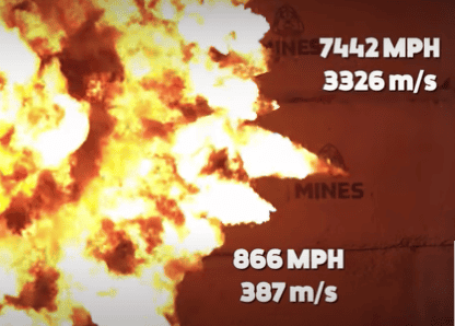

  • #83
Baluncore said:
The speed of a bullet is quite irrelevant to the speed of sound.
Some bullets are supersonic, at Mach 2.5, others are subsonic, at Mack 0.4
In the case of the quoted video, the bullet is reported at 8:09 to be travelling at
387 m/sec which is Mach 1.1 in air at NTP.

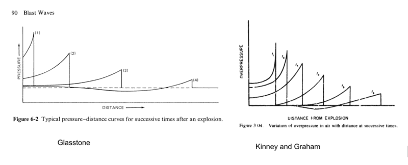

  • #89
Baluncore said:
The back of the shock-front is hotter than the front of the shock-front, so the back of the wave catches up with the front of the wave. That keeps the wave steep. I call that self-sharpening.
But don't both Glasstone and Kinney suggest that, if anything, the back of the blast wave travels more slowly than the shock front, causing the back of the blast wave to lag further and further behind the shock front, rather than catch up as the blast wave travels away from the blast?

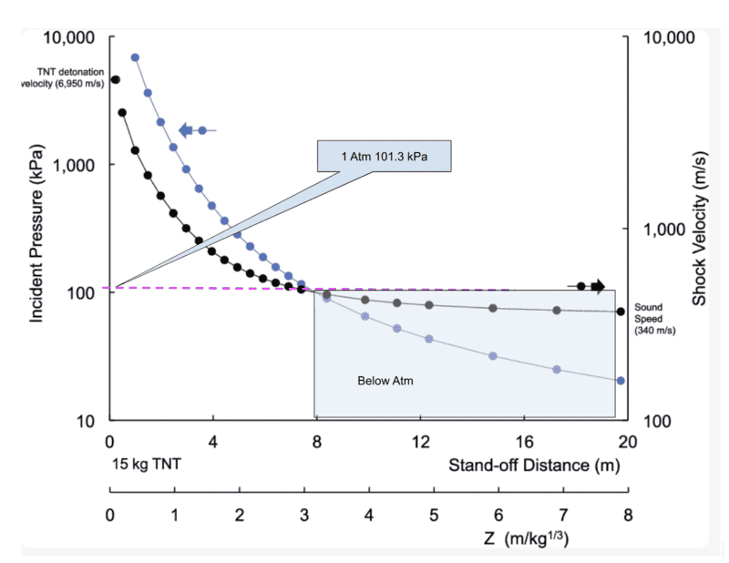

sophiecentaur said:
But will the wave maintain its profile until it slows to sonic speed. The 'wave' is surely more of a pulse which will disperse as soon as it's formed and you then have to ask which bit of the wavefront counts in the speed calculation?
If you observe a pulse, launched from a supersonic event, at various distances from its formation then is it not true that the pulse will spread out in time / distance? Can there be an answer to the OP question? I know that many people claim that the sonic boom they hear is actually a shock wave (don't ask for references) but PF has discussed this several times and my memory tells me that the wave acquires sonic speed very near the plane's path.
Any images of suitable graphs available?
Here's a graph of the pressure and velocity of a blast wave from 15 kg of TNT:
As you can see, after just 20 meters the blast wave has fallen from nearly 7,000 m/s to roughly the speed of sound at 340 m/s. Graph referenced from this article on Injury and death to armored passenger-vehicle occupants and ground personnel from explosive shock waves.
