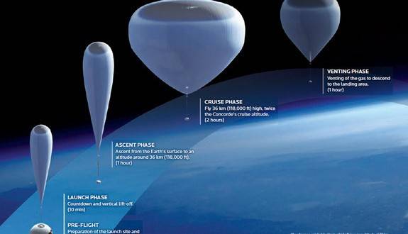

There's two main types of lifting-gas airships: rigid (Zeppelins) and inflatable (balloons). In neither case is the lifting gas significantly pressurized (except maybe a little for structural rigidity in a Zeppelin?). All that would do is make it heavier/less buoyant. In a balloon the pressure is always exactly equal to atmospheric pressure, so the volume increases as the balloon rises. That's why high altitude balloons look deflated when they take off and inflated when at altitude. The buoyancy of these balloons is roughly constant and mass/weight of lifting gas is constant, except it can be varied for the purpose of control by pumping it out of the envelope and into tanks or venting it. Maximum altitude is reached when the balloon is fully inflated.
https://idstch.com/space/ascending-...eric-balloons-and-high-altitude-surveillance/
Zeppelins and blimps are roughly neutrally buoyant. They are powered and fly with the use of engines/fans, so they aren't as much at the mercy of their buoyancy, but the control techniques are similar: https://en.wikipedia.org/wiki/Buoyancy_compensator_(aviation)#Buoyancy_compensation
