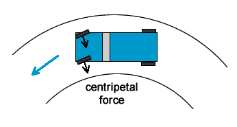

How is static friction the centripetal force during a car turning?
In summary: Sorry, I'm getting confused here. In the case of a car turning, there is a centripetal force that is created due to the friction of the wheels against the ground. However, this force is created even if the car is not being driven by an engine. Is that correct?Yes, that is correct.

Summary:: I understand for a car to turn, there must be a centripetal force. As the car turns it is friction of the front wheels creates an inward force. How, looking for a conceptual answer
Hello, as you can see i am trying to understand conceptually how the tires during turning create a centripetal force. It was explained to me that as we turn the car tires, the tires similar to a ski or a wedge, now want to push the ground to the side and forward. If the ground was loose, this makes sense as the tires would slide forward and scrap the ground to the side. Is it this force of friction that causes the ground to push back, have a perpendicular component, pushing the car inward and turn?
As you negotiate a turn, if you are turning left, your wheels are pushing to the right against the floor. Static friction allows the floor to "push back" against your wheels, allowing you to turn left.
At the heart of your question is the question of how a wheel works.
A ('perfect') wheel provides no restricted movement in one direction whilst preventing movement in the perpendicular direction, subject to the static friction between the wheel and the surface. A rolling wheel is essentially static with the ground at the moment it rolls over it (nothwithstanding a more complex discussion about 'tyre slip', which isn't a necessary part of that discussion).
A vehicle rolling along in the direction of the unrestricted rolling direction of its wheels has an incipient restriction perpendicular to those wheels. If perturbed, either through forces acting on the vehicle or by perturbations in the angles of those wheels, that friction force, perpendicular to the free rolling direction of the wheel, will be conducted into the wheel hub and thus the vehicle that retains the hub on its chassis.
If some, but not all, the wheels are perturbed, then there may be a yawing torque resultant on the vehicle, about the cross-section of the projected rolling axes of the wheels.

There is a theory expounded by certain engineers that say a tyre can only generate grip if it is slipping. This is a misunderstanding of incipient forces at a boundary of surface energies. There is no need to revert to a discussion of tyres when discussing how wheels work.
Imagine a surface of fine needle like structures and very narrow metal wheels passing through and between them. You would still expect a wheeled vehicle to turn, but there would not be any slip.
The OP's question is fundamentally about the functioning of wheels, they allow a hub to move in one direction but not in the other.
I'd also like to dispel one other massive, humongous myth; that only the front wheels steer.
The OPs picture shows only forces on the front wheels, this is very wrong. All 4 wheels steer and apply the necessary force, it is the relative directions of the wheels to the vehicle motion (rotation rate) that induces yaw. If the car is already in a yawing motion, a lateral steer can still be achieved with all wheels pointing in the same direction, at that point the wheels are opposing an existing yaw, rather than creating one, and this is a '4-wheel drift'.
