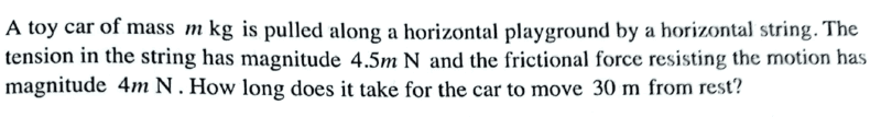

See attached.
Mechanics
In my approach,
##T - R = ma##
##4.5m - 4m = ma##
and
##s = \dfrac{1}{2} at^2##
##a=0.5##
therefore,
##30 = 0.5 ×0.5 ×t^2##
##t^2 = \sqrt {120} = 10.95## seconds ##≈11## seconds.
Your insight is welcome or better approach...
Looks good to me!
Likes chwala
chwala said:
In my approach,
##T - R = ma##
##4.5m - 4m = ma##
So ##0.5m = ma \Rightarrow a = 0.5##
It was somewhat confusing to me to see the equation ##s = \frac 1 2 at^2## thrown in before the conclusion stating the value of a.

@Mark44 makes a good point. It's a good idea to present your work logically so there can be no doubt about the steps you took. This is especially important if you must hand in your work to be graded!
(I knew what you meant, but still.)
Likes SammyS and Mark44
I found it disturbing to have ##m## presented as a pure number rather than as a mass. This means that the usual physics formula: ##F=ma## is not dimensionally correct.
Nonetheless, turning a blind eye to the inconsistent units, the result of the calculation is correct.
But question has clearly indicated ##m## as the mass. I do not understand what you mean by stating that it is given as a number. The net force on the toy car is in equilibrium and therefore the usual physics formula ##F= ma## is still dimensionally correct.
  • Skeptical
Likes jbriggs444
In the question, ##m## as specified is a number. E.g. if the car has a mass of ##2kg##, then ##m =2##. ##m## itself does not have units.
Note that the other data, such as specifying a force of ##4m \ N## only makes sense dimensionally if ##m## is a number.
I thought it was an odd construction, but not particularly disturbing.
Likes hutchphd, jbriggs444 and MatinSAR
