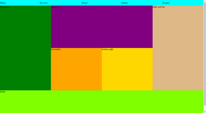

TL;DR Summary
CSS Grids example
I built these using CSS Grids very easily.
Source: https://www.quackit.com/css/grid/tutorial/create_a_website_layout.cfm
But the first one is different and requires different logic.
I can't use grid-template-areas there for whole grid.
This is my code for the last layout(I've to edit height and width there).

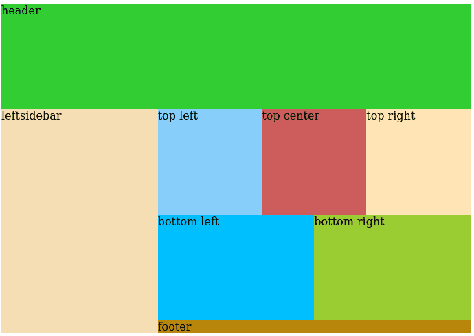

One trick for the layout you a trying to achieve is to count consider it to consist of 5 columns instead of 4 and let the 2nd row orange and 3rd row blue and green all span two columns.
Alternatively you can let the two rows span a single column and put two more (independent) grids or similar in each row.
I would do it with the help of flex display:
HTML:
<div class="container">
      <div class="header">header</div>
      <div class="leftsidebar">leftsidebar</div>
      <div class="main-top">
        <div class="top-left">top left</div>
        <div class="top-center">top center</div>
        <div class="top-right">top right</div>
      </div>
      <div class="bottom-left">bottom left</div>
      <div class="bottom-right">bottom right</div>
      <div class="footer">footer</div>
    </div>

Can you do grid within grid?
That’s what we would do in Java gridbag layouts when things didn’t work quite right.
We would create a complex component with one grid layout and insert the component into a bigger grid layout.
nested grids do exist, I tried a bit but could not make it work.
Using the following CSS with the same HTML as in post #4, I get the same result by having main-top with display set as grid and removing the width of the top containers:
