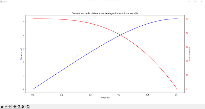

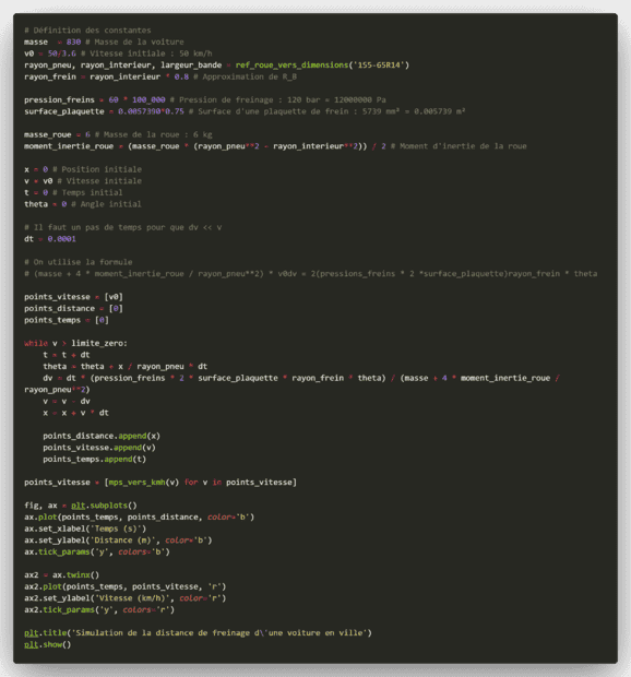

Okay, as I want to be able to simulate the evolution of the distance over time, I will try to figure out ##\text{d}v##
I worked by myself using all your stuff and a bit with my teacher who validated the main part
I use french physics notations, but it may not be a big deal (##J_\Delta = I## for you and I think that's it)
I stopped here last time :
$$\displaystyle \frac{1}{2}M({v_0}^2-v^2) + 4 * \frac{1}{2}J_\Delta({\omega_0}^2-\omega^2) = 2F_BR_B \theta$$
As ##v = v_0 + \text{d}v## (a small step of speed):
$$\displaystyle \frac{1}{2}M((v+v_0)(v-v_0)) + 4 * \frac{1}{2}J_\Delta({\omega_0}^2-\omega^2) = 2F_BR_B \theta$$
$$\displaystyle \frac{1}{2}M((2v_0+\text{d}v)(\text{d}v)) + 4 * \frac{1}{2}J_\Delta({\omega_0}^2-\omega^2) = 2F_BR_B \theta$$
$$\displaystyle Mv_0\text{d}v + \text O(\text{d}v^2) + 4 * \frac{1}{2}J_\Delta({\omega_0}^2-\omega^2) = 2F_BR_B \theta$$
Because ##\displaystyle\omega = \frac{v}{R_\text{ext}}## :
$$\displaystyle Mv_0\text{d}v + 4 * \frac{1}{2}J_\Delta\bigg(\frac{{v_0}^2}{{R_\text{ext}}^2}-\frac{{v}^2}{{R_\text{ext}}^2}\bigg) + \text{O}(\text{d}v^2) = 2F_BR_B \theta$$
$$\displaystyle Mv_0\text{d}v + 4 * \frac{1}{2}J_\Delta\bigg(\frac{1}{{R_\text{ext}}^2}\bigg({v_0}^2-v^2 \bigg)\bigg) + \text{O}(\text{d}v^2) = 2F_BR_B \theta$$
$$\displaystyle Mv_0\text{d}v + 4 J_\Delta\bigg(\frac{v_0 \text{d}v}{{R_\text{ext}}^2}\bigg) + \text{O}(\text{d}v^2) = 2F_BR_B \theta$$
$$\displaystyle\bigg(M + 4\frac{J_\Delta}{{R_\text{ext}}^2}\bigg)v_0 \text{d}v + \text{O}(\text{d}v^2) = 2F_BR_B \theta$$
From here, I have not shown my physics teacher
##\displaystyle v = {R_\text{ext}} \frac{\text{d}\theta}{\text{d}t}## so ##\displaystyle \text{d}v = {R_\text{ext}}\frac{\text{d}\theta}{\text{d}t}## so ##\displaystyle\text{d}\theta = \frac{\text{d}v\text{d}t}{R_\text{ext}}##
As ##\theta = \theta_0 + \text{d}\theta## (a small step of rotation) :
$$\displaystyle\bigg(M + 4\frac{J_\Delta}{{R_\text{ext}}^2}\bigg)v_0 \text{d}v + \text{O}(\text{d}v^2) = 2F_BR_B\bigg(\theta_0 + \frac{\text{d}v \text{d}t}{R}\bigg)$$
$$\displaystyle\bigg(M + 4\frac{J_\Delta}{{R_\text{ext}}^2}\bigg)v_0 \text{d}v + \text{O}(\text{d}v^2) = 2F_BR_B\frac{\text{d}v}{R}\text{d}t + 2F_BR_B \theta_0$$
So now with a little bit of python programming, I can simulate the distance traveled over time by little incrementations of time ##\text{d}t##
This is a case of constant acceleration. That means that there is a SUVAT equation for this. No need for any differential equations:$$s=v_0t + \frac{1}{2}at^2$$.
Sure, one can do it with Euler integration and Python or your choice of language. But with an analytic solution so close at hand, there seems little point in resorting to numerical methods.
Having a canned solution against which to compare a numerical result might give you a little bit of experience seeing the behavior of different numerical approaches. Here is an article to give you a taste.
http://faculty.olin.edu/bstorey/Notes/DiffEq.pdf
Things get interesting if ##F_B## is a function of ##v## (first order differential equation) or of ##x## (second order).

I don't want to solve a differential equation, I want to simulate it with programming :
I will set ##v_0## and the others parameters and will calculate ##v## and ##x## at each point by increments of time small enough so that ##\text{d}v## doesn't change a lot, this will give me a plot of distance traveled over time.
