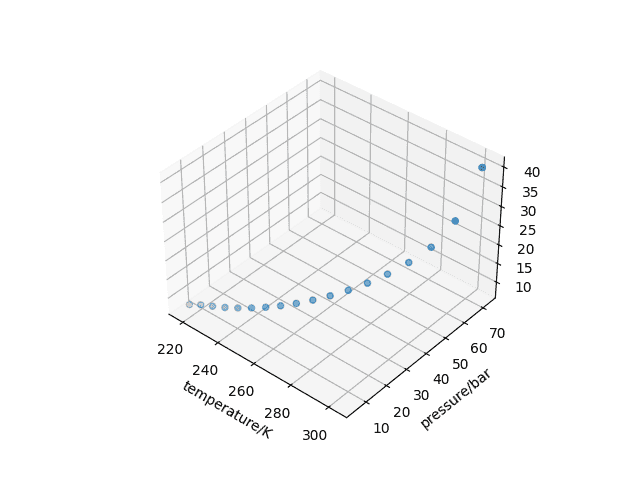

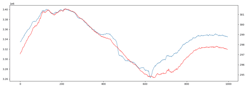

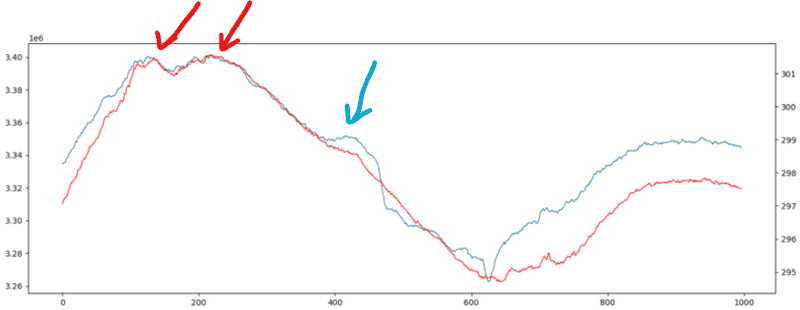

I have also included the time series. The pressure (blue, left axis) is in Pa and the temperature (red, right axis) in Kelvin. On x is the time series index, so multiplied by two minutes is the time.

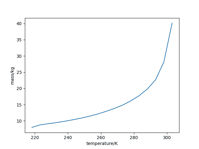

I have now a curve for ##\mathrm{CO}_2##, because the implementation was easier than water. But I had to set the initial value at a somewhat arbitrary value of 8kg.
The mass and temperature are decreasing as the tank expels gas, not increasing. The curve you presented would be for an initial mass of ~40 kg (if it is correct).
I implemented it with the python odeint and since my table is sorted with respect to temperature, my initial value is with respect to the lowest temperature. I have also plotted the 3D graph with temperature and pressure, where I observe what you said. As I release gas, or decrease pressure, the temperature and mass falls.

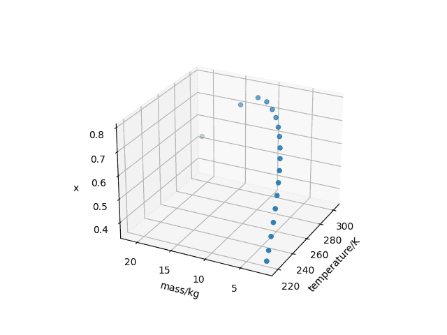

You should also show a plot of he mass fraction of vapor x as a function of temperature and or mass. Note that the mass fraction vapor in the tank is an initial condition for the calculation.

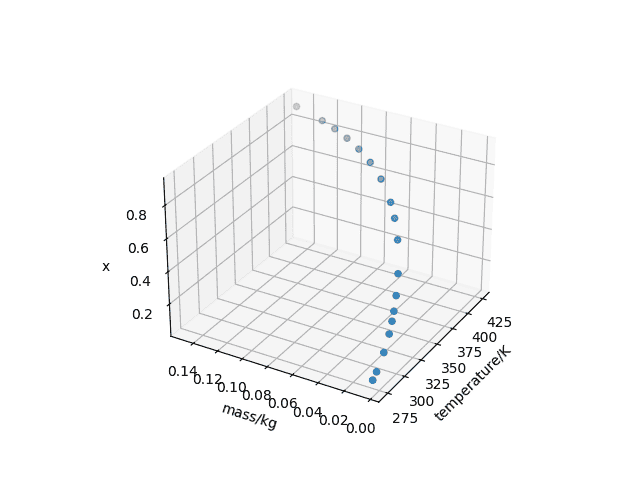

Here is the plot for x in dependance of mass and temperature for ##\mathrm{CO}_2##. I had to play with my initial condition, because unfortunately I cannot measure it right now. So I adjusted it until x was between 0 and 1. The initial mass, as you can see, is now at 2kg instead of the previous 8kg, else I got negative x.
But all I learned from this is that it is "garbage in, garbage out".

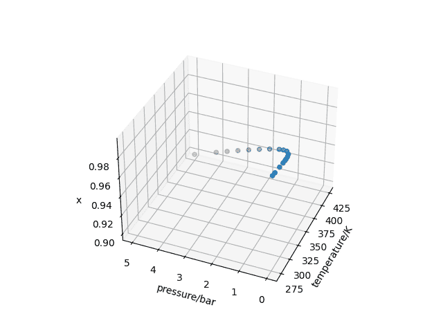

You need to integrate in the negative m direction. In your integrator, make the final temperature less than the initial temperature.
For water, try an initial saturation pressure of 5 bars and an initial mass fraction vapor of 0.9.
Here I have the solution for water with an initial pressure of 5 bars and ##x_0=0.9##, where I used the steam table here. I have also adjusted the integration to your direction.
I am rather sure that this is wrong, because I need an initial mass and a fixed volume.

Here is the new curve for water. It looks plausible, since the more gas I release from the tank, the more vapour I expect.

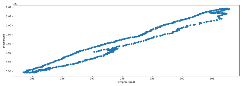

Somwhat yes. I have also included a plot of my data of one gas tank.
Edit: I think I understand now. The integrated curve is the same as the p-T-curve in the phase diagrams, so once I am above or below it, the model has to change between a pure liquid, a liquid-vapour mixture and a pure vapour/gas, right?

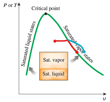

I'm now realizing that, as the discharge happens, the liquid will evaporate while temperature and pressure remain constant due to the phase change. Then, once it's all gas, its expansion will start cooling down the remaining gas.
Could that cooling condense it back?
Picture source: Thermodynamics_ An Engineering Approach by Yunus A. Çengel, Michael A. Boles and Mehmet Kanoglu from McGraw Hill (2023)
What I described in the previous post is using differential equations to model the straight segment. Once you're out of the bell (it's all gas), I thought it'd be fine to use the ideal gas law or something similar to find the remaining gas within the tank from the experimental data but I don't know if the path it follows is the red line bordering the bell or something else like the blue line. I don't think it'd be able to get inside the bell again due to its own cooling though.
Maybe it'd be interesting to model the behavior outside the bell with differential equations too to see how close to the experimental data you can get it instead of directly using the experimental data (PTV) to try to get the mass inside the tank by using ideal gas law.

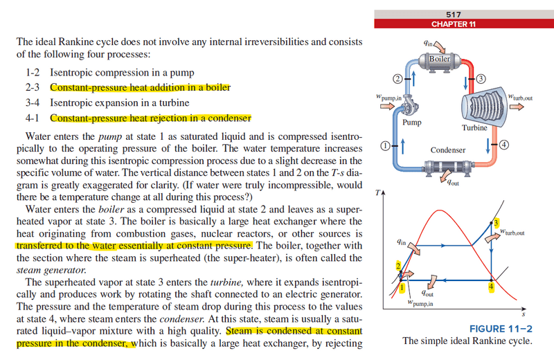

That's probably it. I'm a little rusty on this but, from what I remember, power cycles involving vapor always have that constant behavior inside the bell.
I checked THE book (Çengel) again and the constant pressure is mentioned. I assumed the constant pressure (and temperature) was a result of the phase change but the phase change is actually not even mentioned. So it is imposing a constant pressure inside the bell that is causing the constant temperature during that part of the process.
I don't know how to describe a phase change where the pressure is not held constant then. I feel I need more information.
