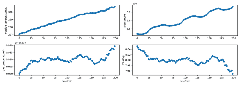

  • #71

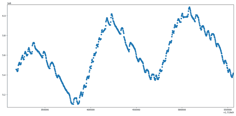

I tried something new and corrected the measured pressure of the CO##_2## tank with the atmospheric pressure. I expected to see a saw like pattern and hopefully small peaks dissapear, but got the plots attached here. The x axis is the Unix epoch time and the y axis is the difference between tank pressure and atmospheric pressure. Unfortunately the atmospheric pressure sensor is some 300 meters apart from the tanks.
I am rather discouraged, because we see a rising pressure over a few days and over three months the pressure difference never gets to 0, where I expect a change of tanks to have happened.
Maybe the whole experimental setup is faulty and needs revisiting?

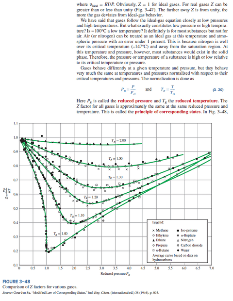

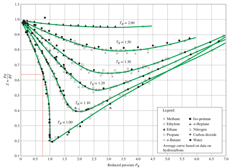

I'm using a different approach to the one you used there and got a different result too.
Using the ideal gas law being so close to the saturation bell doesn't give accurate results but there is an adapted formula for that.

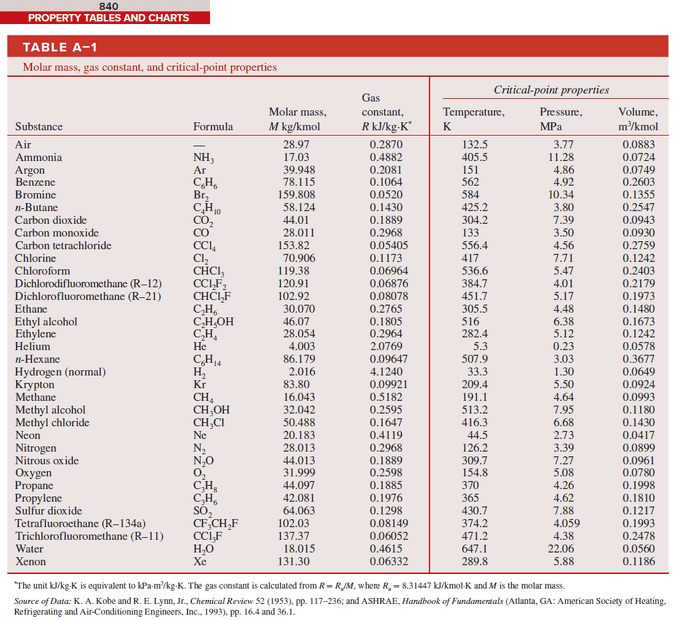

The critical-point of ##\mathrm{CO_2}## is ##P_{cr}=7.39 \ \mathrm{MPa}## and ##T_{cr}=304.2 \ \mathrm{K}##.
Therefore, from your data, the reduced pressure and reduced temperature are:
$$T_R = \frac{T}{T_{cr}}=\frac{297.1}{304.2}=0.98$$
$$P_R = \frac{P}{P_{cr}}=\frac{5.43}{7.39}=0.75$$
So your compressibility factor ##Z## should be around ##Z=0.64##.

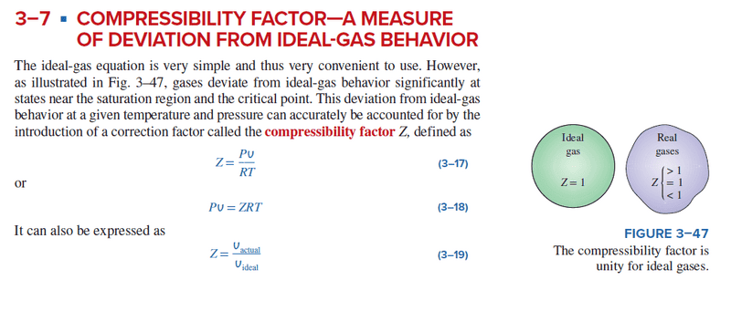

From the definition of ##Z##, it is possible to obtain the specific volume of the gas.
(Using SI units whenever units don't cancel)
$$Z = \frac{Pv}{RT} \rightarrow v = \frac{ZRT}{P}=\frac{0.64*188.9*297.1}{5.43*10^6}=0.006615 \ \mathrm{m^3/kg}$$
Lastly, knowing the tank's volume is ##V = 0.05 \ \mathrm{m^3}## we can find the actual mass.
$$v=V/m \rightarrow m=V/v=\frac{0.05}{0.006615}=7.56 \ \mathrm{kg}$$
I'm not sure if it's my first or second time in my life doing these calculations but I followed the book "Thermodynamics An Engineering Approach" by the letter so I believe it'd be OK. Feel free to point out any errors or comments.

I believe those green curves defining ##Z## correspond to a 3D surface ##Z(P, T)##. If you can find this surface, it should be fairly straightforward to add it to the code. If not, you could try approximating it with the level of detail necessary for your application.

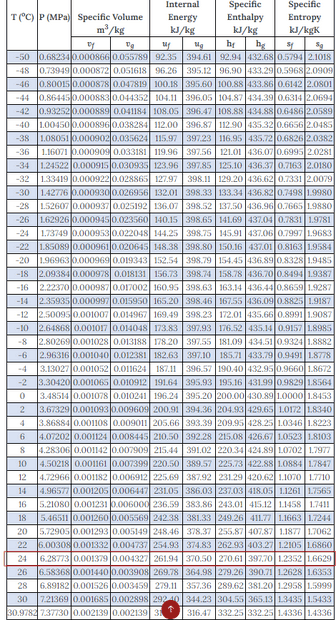

This is much better. Another approach would be to use the conditions in the table that are close to the initial temperature and pressure to estimate z: T=297 K, P=6.29 MPa, v=0.004327 m^3/kg=0.00019039 m^3/mole
$$z=\frac{(6290000)(0.00019039)}{(8.314)(297)}=0.49$$

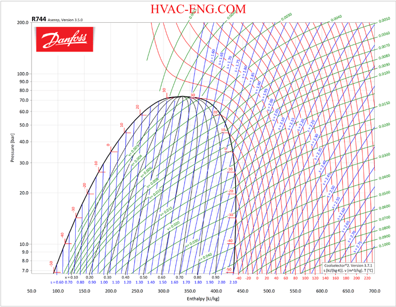

Like I said earlier, the vapor for the initial condition of CO2 is superheated. Therefore, as the tank begins to expel gas, the gas remaining in the tank will experience an isentropic expansion until the 2 phase envelope is readhed. Moran et al, Fundamentals of Engineering Thermodynamics, presents a pressure-enthalpy diagram for CO2 that can be used to follow the isentropic line down to the 2 phase envelope.

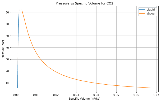

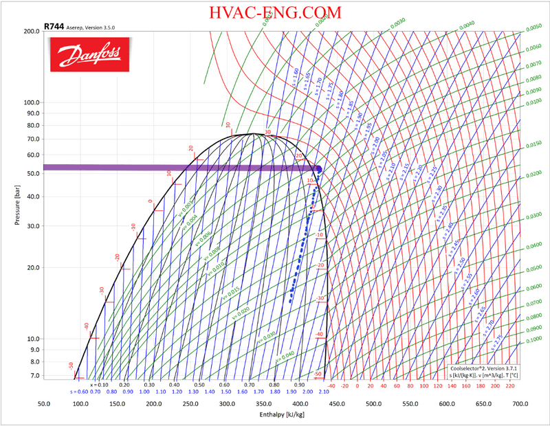

Is this the diagram you're referring to? It says R744 but that should be the same as CO2.
I'm still unsure of how to solve it but, from what you said, I can find the starting point from the known pressure and temperature.
Once it starts discharging, follow the isentropic line reducing pressure up to the new point read by the sensor.
From that, it'd be possible to know the vapor quality right after the release so we can find the portion of liquid and volume inside the tank. The densities of both are known since it's saturated and pressure and temperature are known so it's possible to calculate the mass.
During that process, I think I'd ignore the temperature sensor. We're already assuming it's got the same entropy so the temperature data is not necessary. My reason for ignoring it is its readings are indirect. I'd trust it when it has enough time to reach thermal equilibrium but not in cases like this.
We assumed an isentropic expansion which I believe also means it's adiabatic. It can be assumed that the heat input is not too significant during the discharging process. However, once the release is done and time passes, the tank will keep absorbing heat from the room because it's significantly cooler. As it absorbs heat, all the content will be transformed into gas now that the pressure is lower so it'd be possible to calculate the mass again but using the compressibility factor as mentioned in the previous post.
All this process (this and the procedure from post #73) completely bypasses the need for differential equations. However, to calculate everything in your Python code from your sensor data you'd need to add the functions from the diagrams we used. That is:

Perhaps I should start a new discussion to explore this point in more detail, rather than complicating this one further.
Yes.
Once the tank contents reaches the 2 phase region, the behavior of the contents remaining in the tank is no longer isentropic. This is because pure vapor is being removed from the valve, rather than a representative mixture of liquid and vapor from the tank. That was the idea of the analysis I did.

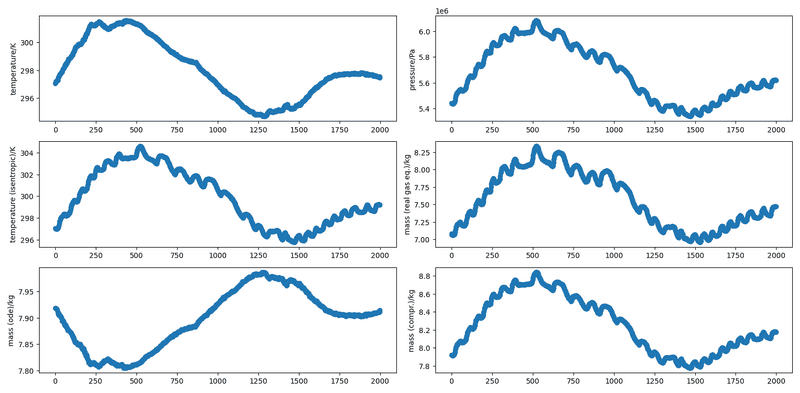

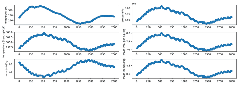

I used the Python package gascompressibility for the compressibility factor and got ~0.61 for the initial values. I calculated the spezific enthropy based on the initial values and then assumed it stayed constant and then calculated the temperature based on pressure and spezific enthropy, all using pyromat. From this calculated temperature I computed the compressibility and used the formula in post #73. In the below plots you see the result in the bottom right corner. Bottom left is the ODE solution with different initial mass based on my 0.61 compressibility. Changing the initial mass manually to the ~7.6kg does not change the shape and just shifts the plot down. The middle graph on the right is based on this. The middle graph on the left is the calculated temperature with constant spezific enthropy. I also checked for the liquid phase with interpolation and can confirm that in this data set no liquid is formed.
We can see that the temperature based on constant spezific enthropy is larger than room temperature T_T
Python code for temperature calculation:
pyromat.config['unit_pressure']='Pa'
pyromat.config['unit_temperature']='K'
co2 = pyromat.get('ig.CO2')
isentropicTemperature = co2.T(p=pressureData, s=co2.s(T=temperatureData[0], p=pressureData[0]))

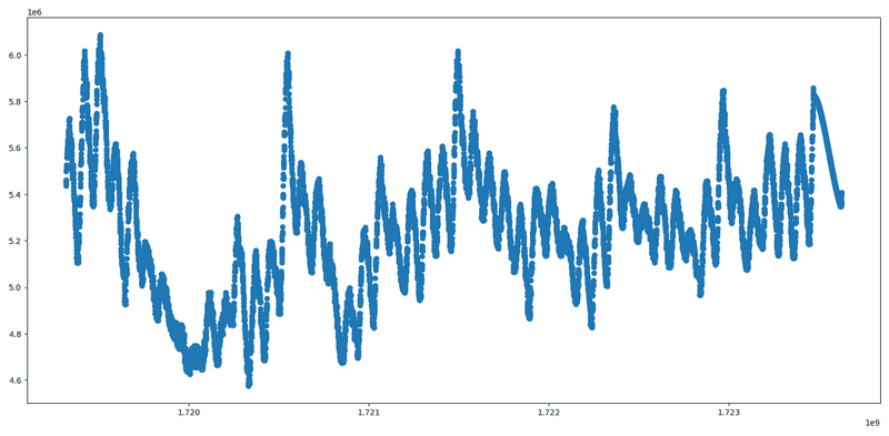

The most accurate mass readings would be done right before the discharges since that's when the tank has had the most time to achieve thermal equilibrium so you can be sure the content is 100% vapor.
That is the problem. I tried to find the time frames, where no discharge was happening by subtracting atmospheric pressure and gas pressure, but I did not get time frames with constant pressure.
  • #84

Where did you get that table?
Leopold89 said:
This way I get a pressure for a given temperature and can check if the measurements are below this limit. If not the program aborts.
Your sensors are reading the pressure inside the tank. Why are you trusting the temperature sensors in each time step instead? Due to your set up, they are indirect measurements of the tank.
I would rather trust the pressure sensors and only trust the temperature sensors when enough time has passed between discharges.

Edit:
"Where did you get that table?"
I copied it from an old German textbook.

Maybe some implementation error. I post my code, too:
Van-der-Waals-equation:

This result is multiplied with ##0.0440098\frac{\mathrm{kg}}{\mathrm{mol}}##.

uData = co2.e(T=temperatureData, p=pressureData)
hData = co2.h(T=temperatureData, p=pressureData)
timeData = np.linspace(0, 2*(len(temperatureData)-1), len(temperatureData))
hOutData = []
qData = []
for i in range(1, len(uData)):
    qData.append(uData[i-1] - uData[i])
    hOutData.append(hData[i-1] - hData[i])
qDotData = np.gradient(qData, timeData[1:])
tDotData = np.gradient(temperatureData, timeData)
initialMass=0.0440098*volume/(z[1]*constants.R*isentropicTemperature[1]/pressureData[1])
sol = odeint(massDerivative, initialMass, timeData[1:], tfirst = False, args=(temperatureData[1:], tDotData[1:], pressureData[1:], hOutData, qData, qDotData, timeData[1:]))
Here the z[1] is the same as in the previous code block.
Edit: I forgot to use the isentropic temperature in the ODE approach but now attached the version using calculated temperature.

Just to be clear, when you post these graphs, temperature and pressure are calculated from initial conditions or are they the values straight from your sensors?
(By the way, you'd be able to copy-paste pictures instead of attaching them if that's more comfortable for you)
You mentioned you have sensors for pressure and temperature. (Even if the temperature is not really from inside the tank, we can address that later)
Can you upload those graphs if you haven't done it already? Because I really can't understand how it's possible that, even if you're ONLY discharging from the tank, we're seeing how pressure rises. Nor I can understand where the jagginess of the curve comes from. I'd expect sudden changes when the valve is open and the smooth behavior towards the new equilibrium point. Could it be electrical noise?
How long does the discharge take? Could you plot the temperature and pressure readings for a couple of days or so? It's to try to guess where are those 4 discharges (2 discharges/day) that you mentioned.
Can you add units to the horizontal axis?
  • #90

OK. So the long-term trends could be influenced by the weather. Would it be possible to plot this with a timestamp (e.g., day, hour, minute, or just day and hour)?
It would be feasible if you know the time at each time step, or you could assume the peak temperature represents the hottest time of day to see if that provides a clear pattern.
It might also help to understand how heat is transferred to the tank. For instance, I'd expect the tank temperature to rise around 15:00 when the room temperature is highest.
In addition to the temperature sensor you've mentioned, do you have another one to monitor the room from which the tank is absorbing heat?
However, those sudden pressure increments don't make sense. I can't figure out what's causing them. I could understand sudden drops in pressure if you're opening the valves to release pressure, but not the opposite. And even that should not cause such jaggedness since you mentioned that the valves only open a couple of times a day.
Can you find out how long the valves remain open? Is it a matter of seconds, minutes, or hours? You said they release small amounts, but I want to see if these releases could overlap with the long-term trends we're attributing to the weather.
Finally, can you share your pressure and temperature (P and T) data from the last plot in the same format you previously used to share the saturation bell for CO2? Ideally, with the timestamp included as well.

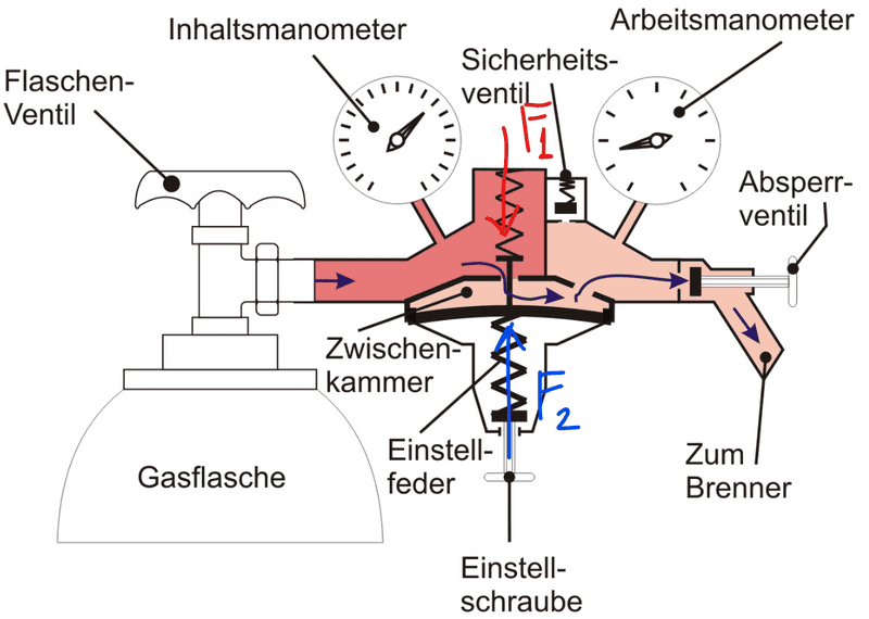

Here is the kind of pressure regulator I am using to vent gas, but in German. Mass should therefore not flow inside. I would not think mass is increasing, but instead that too many simplifications were made or a miscalculation happened somewhere, which is why I posted my code.
If mass increases, ##\Delta m \propto \frac{p_1}{T_1}-\frac{p_2}{T_2}##, I would guess that either the pressure ##p_2## is smaller than it should be or the temperature ##T_2## is larger than it should be. The last case makes sense and for me it means that the heat transfer from room to gas takes time that is not negligible.
Another one of my fruitless ideas is to plot a histogram of enthropy or enthalpy. After each release the peak should move further away and this new expectation value could be used to determine the system variables in equilibrium, but the enthalpy curve looks just like the temperature curve.

With that kind of valve, the mass flow should only be towards the exit (only discharges happening).
And it should only depend on the forces ##F_1## and ##F_2## which are defined by the difference in pressure between the chambers (inside the tank and room pressure for simplification) and the springs installed.
In summary, once the pressure tank goes beyond a certain pressure limit defined by the ambient pressure and the springs, the valve will open.
In this case, since the input energy that could cause the valve opening simply comes from the heat in the room, I believe the released mass will be very small until pressure equilibrium is reached again.
The content of the tank might not even go inside the bell because of how small is the release. As you suggested in a previous post your program is not aborting the calculation so the content seems to be 100% gas all the time.

  • #95
Let’s see what you get if you plot the measured outside temperature at time t as a function of the measured inside pressure at time t.
  • #96
In above plot I believe to see how the temperature is maximal between 12:00 and 16:00, but the pressure is maximal at around 16:00, maybe a little later than the temperature.

Leopold89 said:
Oh, no. I plotted the gauge pressures. The absolute pressures are only in post #71.
I calculate precisely this in post #88. It is the bottom right graph.
Well, obviously there is something wrong because the mass should never increase.

Juanda said:
It is designed to close when the tank being filled reaches a set pressure.
Note that the outlet pressure, not the source-tank pressure, acts on the diaphragm, closing the valve.
("absperrventil", on the right, is the "shut-off valve"
'Zum Brenner' translates as 'to the burner'.)
