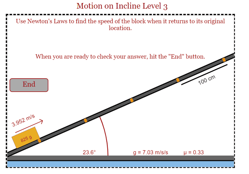

Use Newton's Laws to find the speed of the block when it returns to its original location.
a = g sin theta - u g cos theta
Basically the problem is giving me an initial velocity to start with it goes up the incline before it comes back down. I know how to do everything else in the problem but solve for the initial acceleration up the incline. What would I need to calculate to solve this?

Have you drawn a Free Body Diagram (FBD) for the block to show the forces acting? What does it tell you about the net force acting on the block?

That equation does not apply throughout the sequence. Rather than use it blindly, follow @gneill's advice to draw FBDs, but consider the up and down phases separately..
